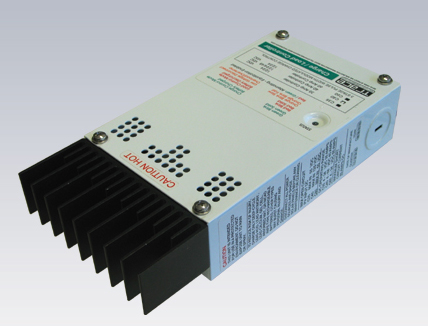

It depends on how you connect it up to your rotor. If you plan to attach a rotor directly to your 5/8" shaft then you could use a Xantrex C-40 charge controller.
You can also connect a digital meter up to the C-40 and remotely monitor your wind energy values such as W/V/A Ah per day/ Totallizing Ah's.

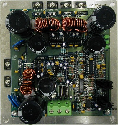

If you plan to use a geared system and the motor enjoys high RPM's then I would recomend a DC to DC converter like the one shown below.
Voltage Regulation Mode
Proportional:
    This standard unit regulates the output voltage proportional to 1/4 the input when connected 48 V input and regulates the output to 4 X input when connected 12 V input. This characteristic, when connected across 4 X 12 V batteries in a 48 V configuration, will keep the batteries at equal voltages.
Fixed:
    Special units are available for example EQ 12/48-30 RXX where XX is the voltage on the 12 V side that the voltage is to be regulated to. For example, EQ 12/48-30 R13.6 will output 13.6 V @ 30 amps to either power a 12 V load or charge a 12 V battery to 13.6 V.
        I will draw you up a wiring diagram if you like.
