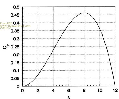

It all revolves around this graph to illustrate what's outlined above.
If blades are giving more power at "X" m/s of wind providing a lower RPM than what a PMA can generate at that RPM, it could go pear shaped! I'm more referring to what happens in the more extreme conditions, where the blades take off and the PMA just can't keep up with whats going on.
A well designed furling system should keep things in check, but would have to be carefully designed to operate at the correct wind speed.Edited by DaveP68 2017-07-02

As a rude rule of thumb for a set blade shape.... more blades, means lower tsr due in part to the wake of the proceeding blade... add another blade and the TSR drops.... and on an old pumper we used to pull off half the blades to speed it up... BUT....
But in reality, the number of blades should make no difference to your calculations.
The CP limit is .6... the Betz limit... calculated by Betz on the basis of using an infinite number of blades..... interesting.
Real life Cp of .5 is obtainable if your good.
Windmission of Netherlands used to build 12 blade windflowers of a CP of .47
You can still find some pics on the net of them... very skinny blades, but reasonable TSR up to 4kw some driving induction motors from memory.
In theory, any number of blades can be used for whatever TSR you wish, but building it in the real world may not be so easy.... so an infinite number of blades of infinite thinness will work fine too... ask Betz.... but try to actually build it... or make it so it stands up to the wind... and there is the problem.
The solidity of the 12 blades compared to 3 is the same if the blade chord is decreased proportionally i suspect..... but not if you keep adding the same blade profile. .... thats the difference I think.
