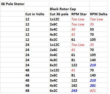

Hi Iv just joined after some time just looking and thinking I must have a go at a windmill, for now I want to just play around and see if I can get any decent results, I got a F&P 36 POLE .6MM wire unit, with a black cap 48 pole rotor these are single magnets, from a used washer, in your rewire section there is no mention of this set up. Im after a general speed mill with either 12 volt or 24 volt output, and dont want to have to re solder because I picked the wrong connections. any advice.
Posted: 02:33am 25 Nov 2018
  kalidupakid said   in your rewire section there is no mention of this set up.
F&P stator rewire
I thought this would be your unit. What is different? is it the wire resistance? We can sort something out, getting a motor charging is not rocket surgery. the 5 wiring digrams for a 36 pole is just above the charts. You should be able to click on them to get a larger image.
if you are not sure about some of the formulas to work out amps and watts from free spinning rpm, stator resistance and battery voltage we can help a little with that.

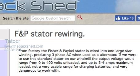

Here it also says that it is empty
I'm wrong? Sorry but my English is very poorEdited by Tatocr 2018-12-07
