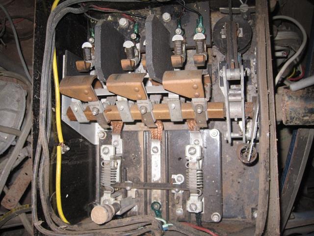

Below is picture of inside my main switch (cover removed for photograph)
Not a transformer anywhere.

That picture of the switch.
I would bet that is a Star Delta Starter BY A.I.E. Engineering. 20Hp?
Nice to see some old gear still in use.
Aaron
Cheers Aaron

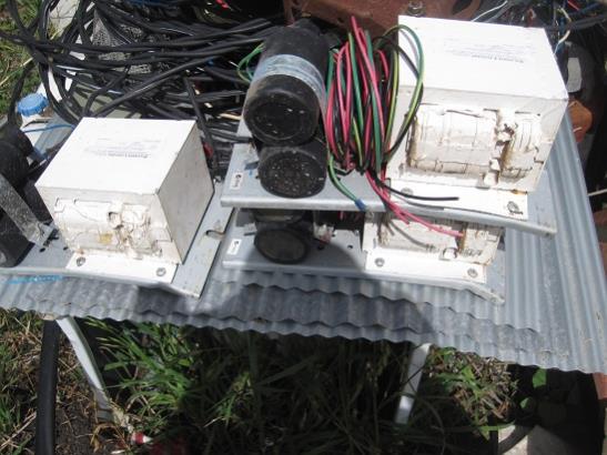

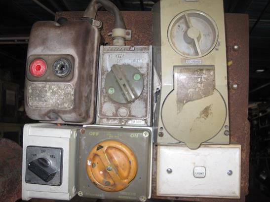

The switch has been upgraded to more modern with reverse

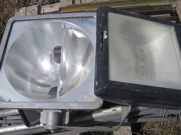

A friend brought me some lights and voltage doublers along with 2 cartons of spare bulbs. The lights are around 400mm square. He said these will light up your lathe!
The doubler ballast transformers - each are seriously heavy
Sylvania Lighting Constant wattage ballast 1500w 500v 3.3a MHL1500/240
These output 500 v at 1500 watts, so one was wired up in reverse.
Holy shades batman - a 60 watt bulb was a bit bright
So a voltage was taken to find 320 v
Maybe a single smaller capacitor is required
In the meantime a transformer with a 50 w down light has been set up
Always Thinking
