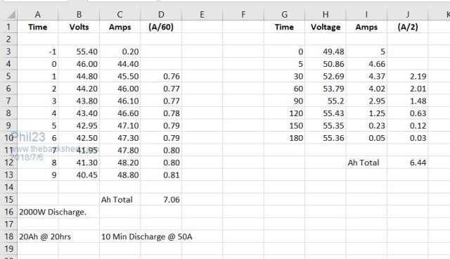

Can probably extend the batteries out with a couple of Anderson leads I use for camping, but they are a few metres long.
Still suspect the Charge/monitoring though as I don't see what I could really consider a bulk charge.
Left table relates to discharge, right to recharge.
7 Ah out on discharge seems pretty realistic, considering it's at 40+A, not the rated 1A.
But charge back in only accumulated to about 6Ah, & voltage is more what I'd consider a float than bulk charge level.
seems like a perfectly normal scenario for a UPS, if you dont have daily power failures it has endless hours to reach full charge, if you wind the voltage up it will cook and corrode the batteries.

  yahoo2 said  if you dont have daily power failures it has endless hours to reach full charge.
it's not daily outages that create the issue. It's extended overvoltage scenarios that cause issues here.
One site reports it every day when a tranny tap changes at around 4:30am in the morn.
That sends the units into a mode where they draw on the batteries to force the mains back down.
They are all line interactive units I have installed; but am starting to think that Online units might perform better in this situation as they would not be relying on their batteries to stabilise the mains.
