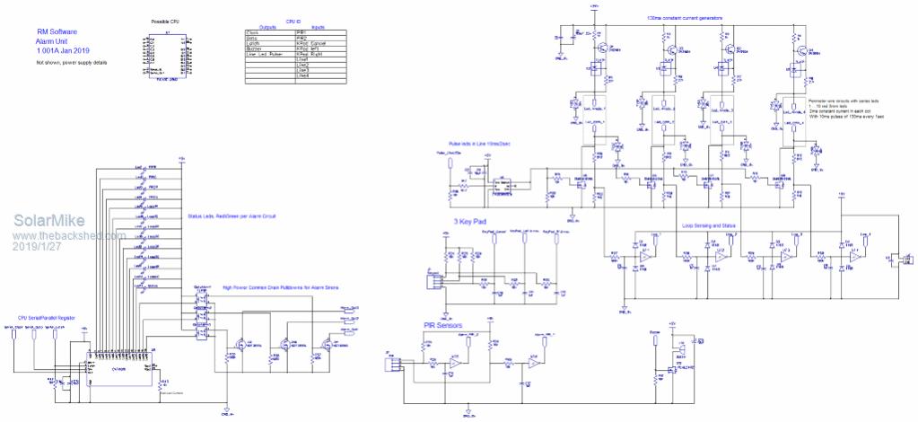

Never thought I would be designing a security alarm, looked around for something off the shelf and couldn't find anything suitable for connecting to external wire loops up to 500m length, so dreamed this circuit up, though this may be of interest to some of you.
Alarm unit runs off the 24v batteries. Wanted to have perimeter alarms that are thin wires running through various fences etc, the wires will have series connected leds that wink to indicate alarms are operating, should any wire circuit be broken by cutting a chain\padlock etc then the unit detects this and sounds the piezo screamers\flashing lights etc. Various internal PIR sensors are included also. Will also add a device to send a txt message when tripped.

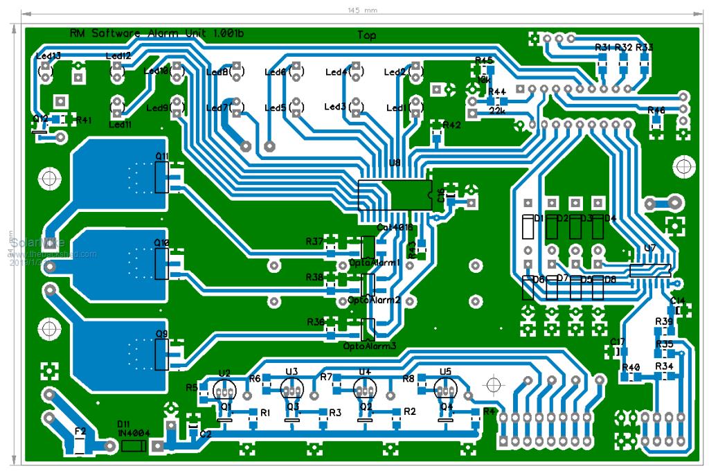

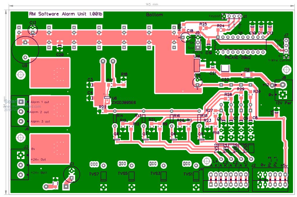

Finally completed the pcb layout, its a bit crammed in places as I wanted it to fit in a case that I had lying around. Original circuit altered somewhat, now using the 16 bit serial to parallel Led driver for status display of sensors and external wire loops, this allows me to use a 20 pin pic and have 2 IO's left over, so added a 1-Wire comms port to allow the alarm to be integrated with the site network used by the soil moisture sensors. Comms module plugs in to the 4 pin connector. In theory once the network master is built it can get the alarm status and elect to send a TXT message to security company. Edit: or make a 1-wire slave to do this job.
PCB top mounts under the lid of a JayCar plastic box (170 x 120mm) with the LEDs poking through, plugs and sockets mount on the bottom layer.
Schema is too big to fit in the blog window, converted to pdf.
2019-01-31_201026_Circuit.pdf
PCB Top:
Bottom:
Thinking about it, the schematic could be simplified a bit, but I wanted to use the components lying on my work bench left over from other jobs.
