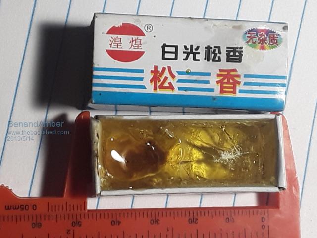

LadyN I make my own solder paste
I ordered a bunch of different types and the kind I make I like a million times better
It's made of Pine Amber you know when a pine tree gets injured it's sap runs out and then Harden's
I heat it up in alcohol it makes for a clear high temperature solder liquid paste
Or you can just leave it as a hard Amber and poke your soldering iron into it
If you like actual paste you can mix it with a little bit of petroleum jelly Vaseline
I never do it that away though I like the smell of the pine and it don't give me headaches like other paste
When you go to clean your board it don't Clump up like the other soldering paste does
You just brush it with rubbing alcohol it comes clean easily
The alcohol evaporates quickly when soldering and leaves behind a very high temperature soldering paste
I cannot say enough good about this type of soldering liquid paste
I will never go back ever!!!!!!!!!!
It is very sticky though if you get it on your fingers
If anyone is interested in making their own soldering liquid paste
This is some of the cheapest Pine Amber that I could find
use two parts alcohol one part Pine resin
This is sold on eBay as regular soldering paste
when you read in the reviews and the people complain it's hard as a rock then you know you got the right stuff
It smells so good and no headachesEdited by BenandAmber 2019-05-15
