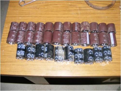

Well Guy's I just went and unsoldered about 36 400 volt caps. All the caps are off brandnew boards I got from work for nothing and I have 3 different uf ratings 330, 470 and 680 uf. I have 12 of each and 10 of the 680uf ones so now the fun will begin.
Cheers BryanEdited by Bryan1 2008-07-21

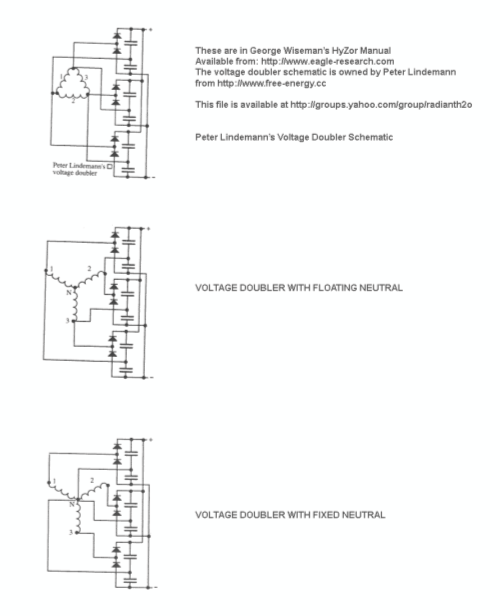

I found this,may help some one. Regards Ivan

Posted: 09:33am 29 Jul 2008
Well Guys,
I was up in my shed tonight working on my my cnc project when I heard the genny take off So I went and turned on the fluke on scope view and the cheap dmm on 10 amp and instantly saw 8 amps on the dmm. I did watch it for about 10 minutes and it looks like 6 of those caps in the picture above, the middle ones 400 volt 470uf put back to back they measured between 216-219uf on the fluke are doing great. I still have the 100S wired in delta and where the genny had to be going like the clapper to make 5 amps with the caps it was doing it easy We're in for storms all week so hopefully tomorrow night I'll get some pic's of the waveform on the fluke and the current on a cheap 30 amp current guage from smithy dicks.
Cheers Bryan

I simply soldered the 2 negative leads together with some 2.5mm wire and soldered some longer wire on each end of the postive lead to connect them to each phase. All up I used 6 of them, 2 for each phase.
Now here's a good question for ya mate Lets say I put 50 or so of those caps in parrallel after the recifier along with a blocking diode from the batterybank. I'm thinking when the cutin starts the caps would hold the voltage then when the genny drops below cutin the caps would discharge current into the batteries. Do you reckon this would be feasable or a waste of time???
Cheers Bryan

I think the only noticeable difference would be to delay startup. The caps would start charging from just over zero volts, and so load the mill just when you don't want it. When the mill finally overcomes the charge load of the caps, they will remain mostly out of circuit until you fall below startup, they would then discharge a tiny bit trying to hold just above startup volts.
As the voltage drops below start up, the caps would maintain their charge until cut in was achieved again. They would then follow the battery volts until below start again...
The caps can no more charge the batteries below cutin volts than the Mill can.
I can see no joy from this arrangement.
If you want to charge below cutin rpm (if there is any worthwhile energy there in the first place worth capturing) then those circuits of Bugs above will help some. But if sized too big may curb cutin too.
.........oztules
