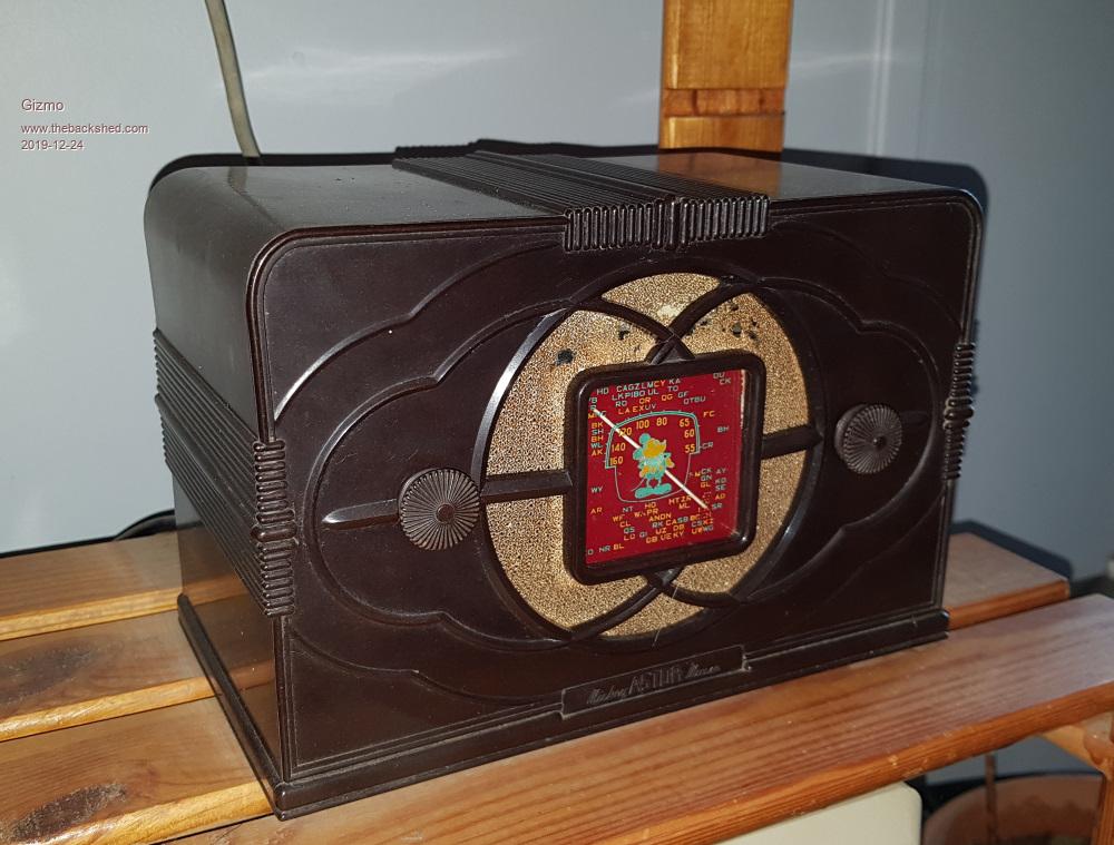

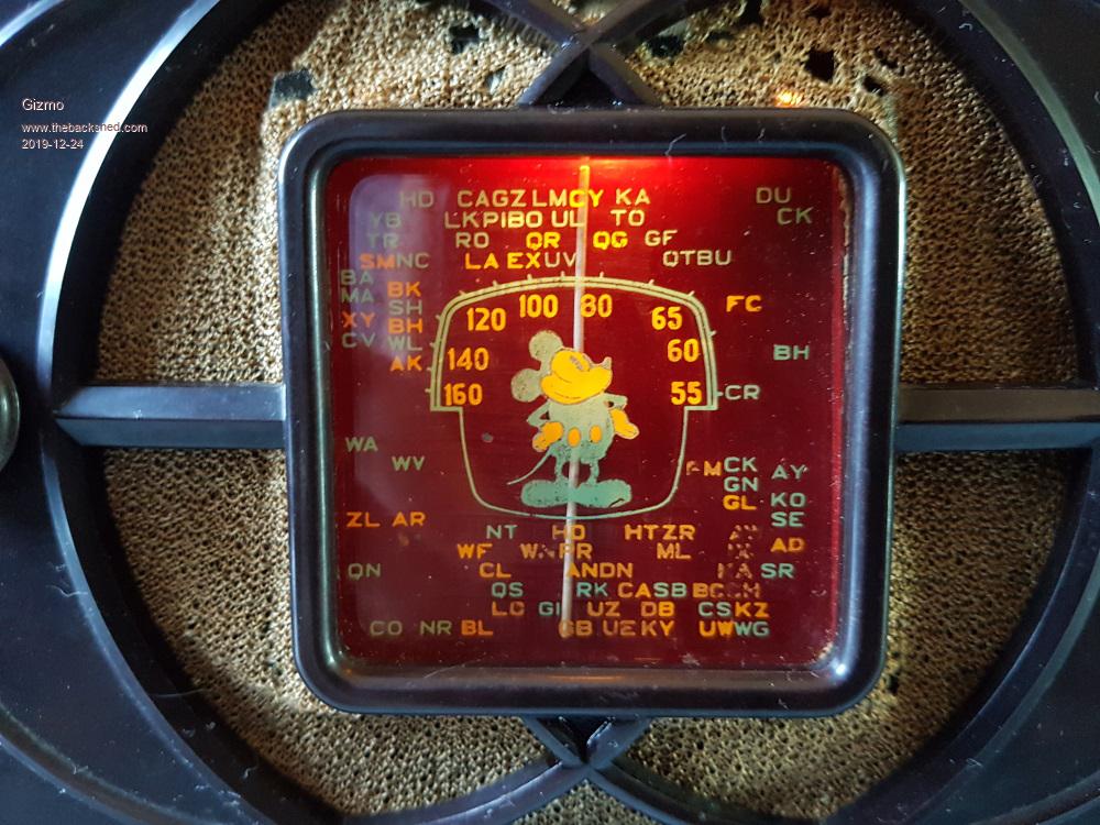

Early this year I picked up this little radio at a auto swap meet. It was mixed up with some car parts, and I grabbed it because I thought it looked nice, and had a mickey mouse figure in the dial and on the back. The case was in perfect condition, it seamed intact, and I paid $15 for it.
Now I'll just give the radio collector readers a moment to pick up their jaws and catch their breath.

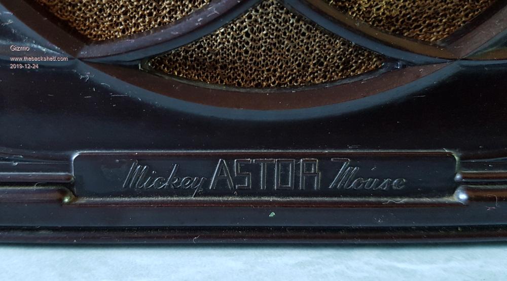

I've since discovered its a highly collectible piece. Made by Astor in Australia in the late 1930's, it was called the Mickey Mouse, a 4 valve mains powered radio. When Disney got wind of it, Astor had to drop the Micky Mouse character off the radio dial, so finding one with the character is not very common.

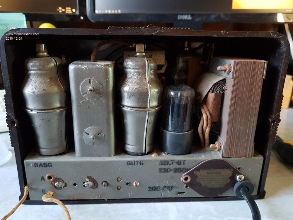

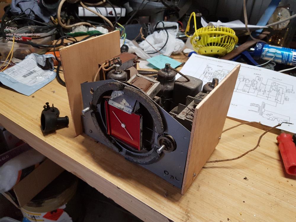

First thing, once the chassis was removed from the case, was to screw on a couple of timber sides so I could flip the radio over and not damage the valves.

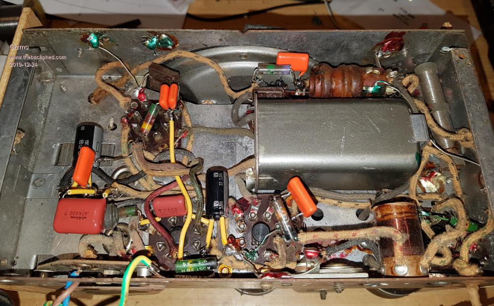

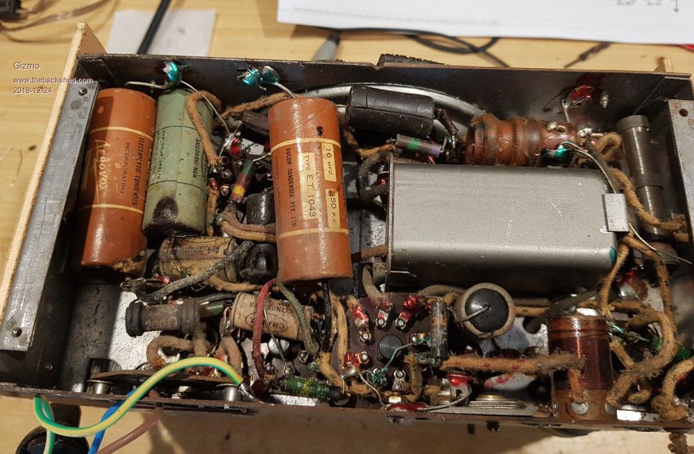

The original cloth power lead was totally serviceable, with exposed wires. The transformer tested ok, so I soldered on a temporary power lead and powered it up. Lots of hum in the speaker once the valves warmed up, so replaced the mains filter caps, and it worked, mostly. Signal was low and it was way off tune. I downloaded a circuit diagram and ordered replacement caps from RS Components.
Once the caps arrived I carefully replaced the old with new, fitted a new power lead, replaced the tuning dial light bulb. I couldnt find any cloth covered power cables locally, and didnt want to sacrifice my clothes iron, so used a black power lead with the original "Clipsal" power plug.

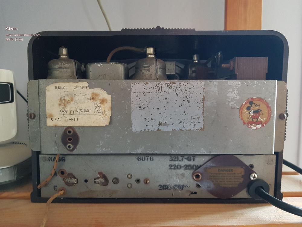

With new caps the radio performed perfectly. Signal was nice and clear. This radio has a steel plate screwed to the back of the bakelite case, thats connected to the aerial wire, to act as a built in aerial. This worked OK, but with a aerial wire plugged in, the performance was brilliant and I didnt feel the need to tune the IF stages.
This is the back with the aerial plate removed.
The circuit is interesting, its only running at 110v, and the speaker uses a electromagnet, part of the DC filter circuit, typical of this era. The valve heaters are connected in series, and one valve acts both as the final audio stage and supply rectifier. The build quality was not good, looked like it was built on a Friday.

The before and afters of the cap replacement and clean up sure is telling of the difference in modern electronics and old.
