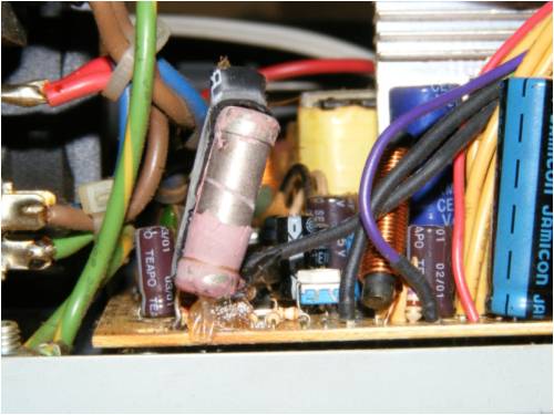

Well thanks to Oztules and Dinges I've decided to embark on a major headache(PSU conversion). I'm using the old psu out the my computer that died and it's plain to see why it bit the dust. What looks like a 2-3 watt sense resistor sort of got hot and melted the outer casing off the resistor. On measuring it with my dmm it measured 6.8 ohms so hopefully thats correct.

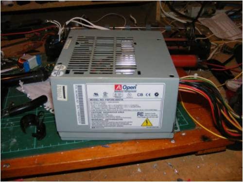

Here's a pic of the psu box

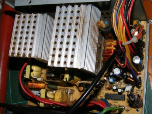

Top veiw of the psu

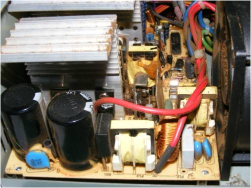

Side veiw of the psu
The main chip is a KA3511 and I mananged to find the
datasheet for it. I searched the net for hours trying to find a schematic with no luck so now the fun will start tracing where everything goes and making one.

probably a short somewhere, to cook that resistor.

Don't you have a PC PSU that's working and uses a TL494 ? That would make the modifications much easier when doing it for the first time. This PC would have to be repaired first, and then you'd still have to modify it.
I haven't seen any PC PSU which didn't use the TL494 or an equivalent; the KA3511 is quite different. You'd also have to trick the over/undervoltage protection (on pin 13/14/15/16); ALL these pins must satisfy the KA3511 (3.3, 5 and 12V) for it to work, if I'm understanding the working correctly; you probably would have to rig up something with a few zeners being driven off a 14-15V spare voltage (IC powersupply ?) to keep that part of the IC happy.
Pin 4 is the voltage error amplifier, the part where you can add a potmeter for voltage control. Unfortunately there's no 2nd opamp that could be used for current control purposes; another advantage of the TL494/KA7500.
Without knowing the exact schematic, I suspect that resistor loads one of the voltage outputs to provide a load to keep the PSU happy. If it's loading the +3.3V output it would draw about 0.5 A, which seems reasonable. Also, 6.8 ohm is a standard value for resistors, so me thinks the resistor is fine, even though it shedded its skin.
Hard to see in your pictures, but does the transformer have a centertap (ground) with flying lead ? That would be handy for current control. On current control... I don't see a 2nd spare opamp in the KA3511 you could use, as you can in a TL494 (=KA7500).

I agree with Dinges, that the resistor is purely a load resistor, and is probably down but not out. It would have failed high resistance if it were dead.
