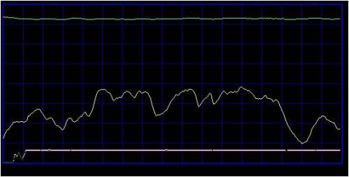

I present some voltage output responses from my F&P mill with boost maximiser, firstly for a 5min window below cutin.
In all graphs, the green trace is the battery voltage. This is a nom 24V battery and the voltage ranged from approx 27.6-28V. The yellow trace is the windmill voltage on the rectifier caps. The white trace is battery current. The voltage is 0-30V full scale. The current has a slight zero offset and is approx 0-18A.
The mill output voltage just rises and falls with the changing rpm. This is 0W output to 24V nom battery.

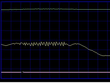

Next is a 1min window just on cutin.
The slight oscillations are at the 0-1W output power to 24V nom battery. The voltage falls off as the mill slows down. This would be about 60-80rpm rotor speed.

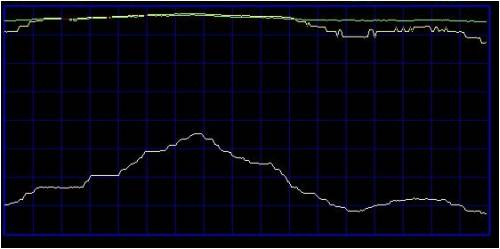

This is a trace at a slightly higher power level, 2-10W to the battery, at 100 data sample readings per second.
There is some ripple on the filter caps at this low power level. The current to the battery is more representative of the actual power transferred. There is no rapid change to mill rpm, that would be indicated by the voltage. The maximiser draws the voltage down and then backs off a bit. A lot of the ripple is from the RAW AC coming from the mill that is not completely filtered by the rectifier caps.

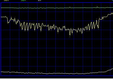

This next graph is between cutin and up to battery voltage.
The windmill voltage is clamped by the battery, at 0.6V above the battery voltage. Current still increases as expected though. The power to the battery is approx 80W when the windmill just reaches the battery voltage.

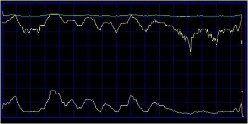

This next trace is a portion of the above, at 50 data sample readings per second.
The cct responds very well to the changing windmill energy.
The ripple decreases as the power levels increase, until, above 130W the boost turns off and the bulk of the windmill current bypasses through the main rectifier.
I doubt I can improve much on the performance of this cct.
