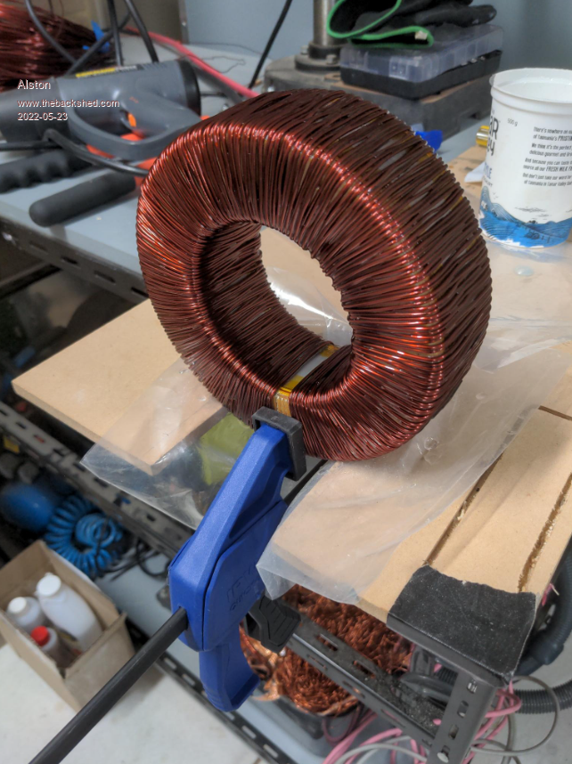

Posted: 08:48am 23 May 2022
Primary done. I wound this from one layer of 1.8mm and one layer of 1.3mm. The groves in the end caps meant this still allowed me to end up with a flat first layer.

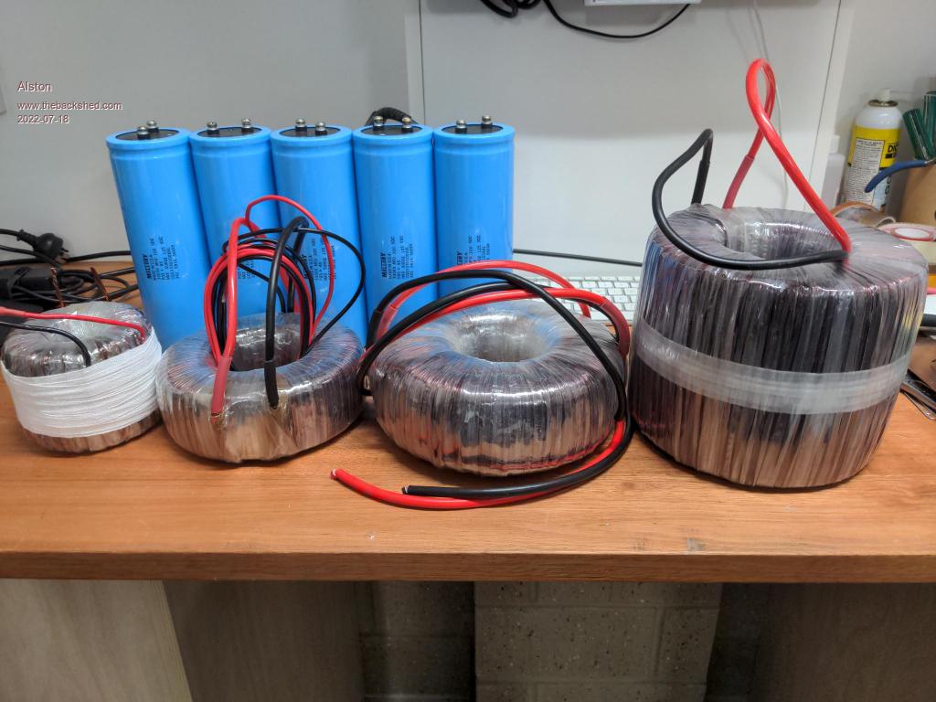

Posted: 01:12pm 18 Jul 2022
Here is the transformer line up. I still need to add the primary to the big transformer and I am going to redo the smallest transformer as I wasn't happy with how it turned out (it was the first one I did).
