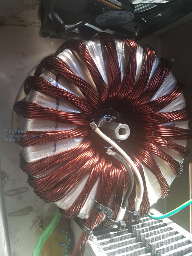

  Madness said  If they are not twisted they want to flatten out at the corners and take up a lot more space preventing getting enough turns on. When they are twisted it holds them together and different wires get to go around different radiuses sort of randomly. My own experience is that it works when twisted. There are 24 turns on the primary below and 9:1 ratio in turns as well as total wire cross-section. Also they all fitted snug against the inside of the core leaving plenty of space for mounting.
https://www.thebackshed.com/forum/uploads/Madness/2018-06-25_204350_20170423_083633.jpg

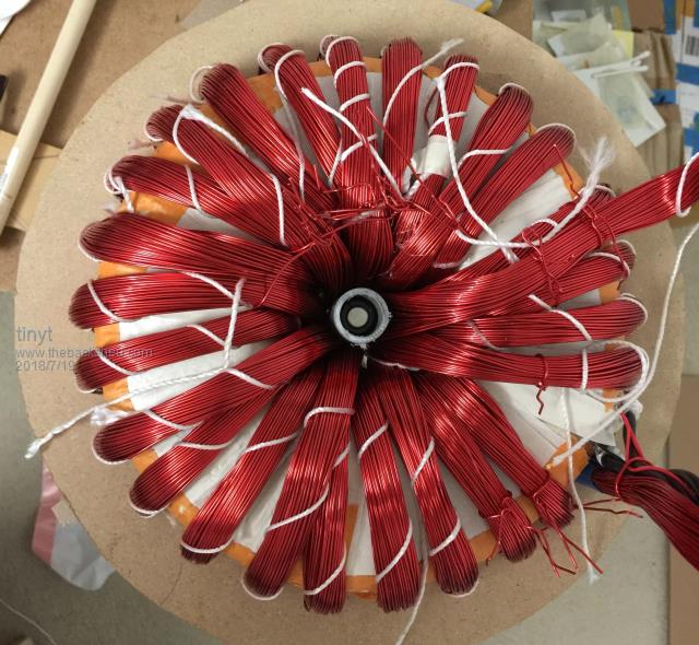

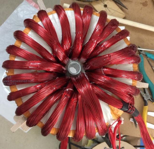

  tinyt said  Klaus, the rope trial winding also gives me a rough estimate of how long the winding will be (about 780 cm. + lead outs). The wire size I picked is much thinner than what I see being used here, still it needs to be 86 strands. Like Tony suggested, I don't intend to twist them into a round bundle. Will post picture whether it is a success or failure.
I like Gary's use of cable ties to secure the lead outs and use of a stand-off(long nut?) instead of a mounting bolt.

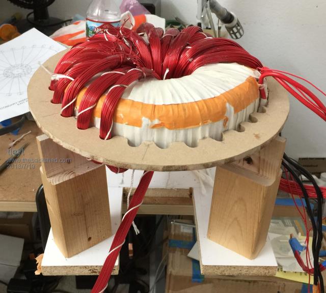

  tinyt said  Pictorial toroid build progress: here  ...

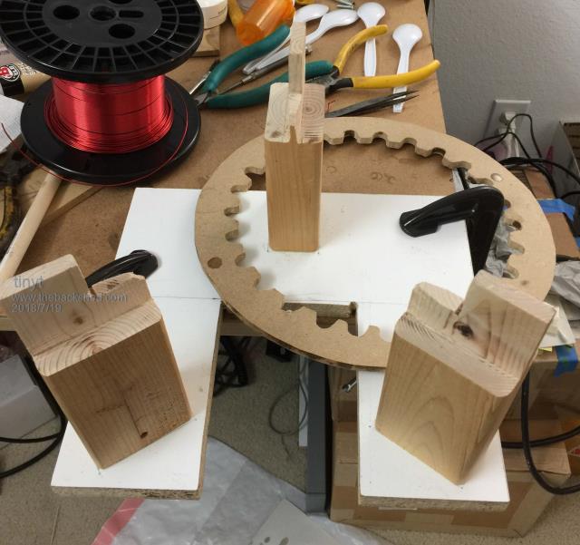

Here is a picture of the fixtures I used. The 3-post stand is where a put the toroid during winding.
The stand allows better access to the bottom of the toroid.

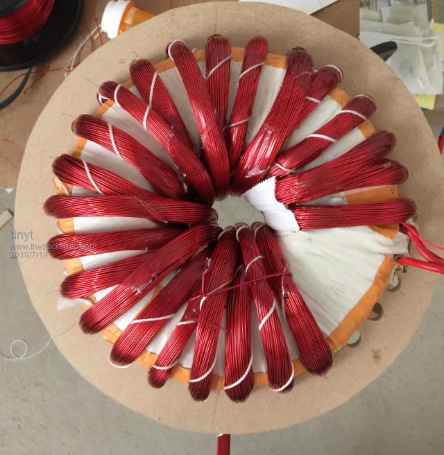

Last 3 turns to go. (toroid top view)
For the mounting bolt insert, I used left over flexible pvc electrical conduit with an OD of 0.82" (20.8mm), I sanded the surface and forced it inside the toroid. Since the pvc is flexible, it became out of round. So, I used an AA size battery, used masking tape to build up the diameter and inserted it in the pvc to restore the round shape. Then I applied epoxy to hold it in place. (toroid flipped for bottom view)
Because epoxy will not stick to pvc, I also applied J-B Weld polyurethane plastic bonder to the pvc insert. (toroid top view)

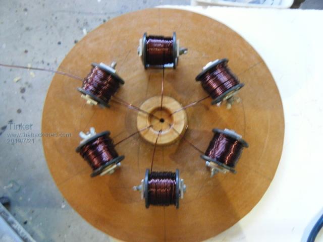

For this I required a 'spinning' gadget, this is what I came up with:
The 'spinning' side.
And the supply side.

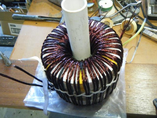

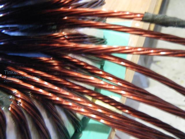

Well, it actually worked - once I had figured out there was a trick or two how to use it .
Here is a close up of my 7 x 1.5mm spun wire.
And now a picture of the first of the three in hand wound on. The white split PVC presses the wire out while the epoxy sets.

I think for the smallest two toroids I will use Klaus's (Tinker) method of twisting 7 wires of 1.7mm wire. They both have the primary winding wound on already, so just need the secondary.
My secondary windings on the larger two toroids are 7 x 1.7mm on the medium and and 6 x 1.8mm on the largest  ...  so 7 x 1.7mm matches very well for the smaller two.

I do like the look of tinyt's primary winding  ...  that is so neat and it obviously worked well for him too  ...  though I don't know how he managed to keep them all tidy and in shape with such a sparse wrapping wire around them. It almost looks like they are epoxied together before being wound  ...  but that would prevent them from bending altogether.

Roger you guessed the way I did it by myself pretty well. Its doable but this job becomes *very* much easier when done by two persons. The following is the two person method.

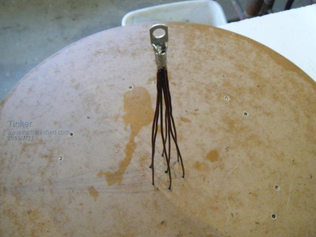

1.measure one turn around the core, I used standard 3 core electrical flex which is very close to twisted 7 strand 1.8mm wire diameter.
2. multiply that by your number of turns and add one meter for twisting losses and end termination (better get this right than one turn too short ).
3. cut 7 strands to this length and de enamel & tin one end of each.
4. wind 6 of those strands on those little spools (they were originally 3mm plumber solder reels), any sturdy spool will do as long as it can fit on your jig and also is wound on easily (I used my lathe, a very low speed drill might work too - wear leather gloves when feeding the wire on). Start loading the spool from the untinned end, important!
5. fit those 6 loaded spools on the jig and feed the wires through the 2mm hole.
Pull them out so all wires are the same length for perhaps 15cm. Feed the 7th wire through the center hole, it can be loosely coiled around itself at this time.
6. arrange the wires so that 6 sit side by side (no cross over from the exit hole) around the central 7th wire. This job can be tricky at first, use cable ties or fuse wire to hold them together. When satisfied that all the 7 wire's tinned ends are parallel and form a proper 7 strand cable, solder them together.
7. for the twisting I had a home made worm drive reduction with 3 socket screw 'chuck', it was powered by an ordinary battery drill. I do not know if the drill could do the job directly, the worm drive made easy work for it and weas also nice and slow so the amount of twisting could easily be checked.
8. to do the job the soldered wire ends were inserted and clamped in my 'chuck'. The 7th (central) wire was stretched out for its full length, a fishing line swivel attached to it and then tied off via some string to my fence. It is *important* to keep the central wire straight and that it can freely turn so the 6 wires are neatly spun around it.
9. to proceed, one person holds the disk jig and walks slowly backward, pulling the wire out at the same time while the other person powers the twisting drive.
