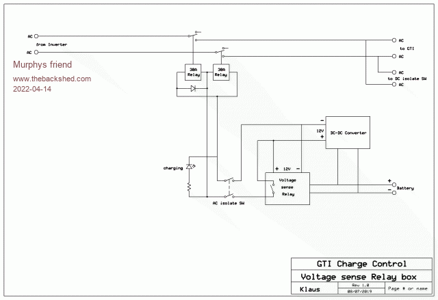

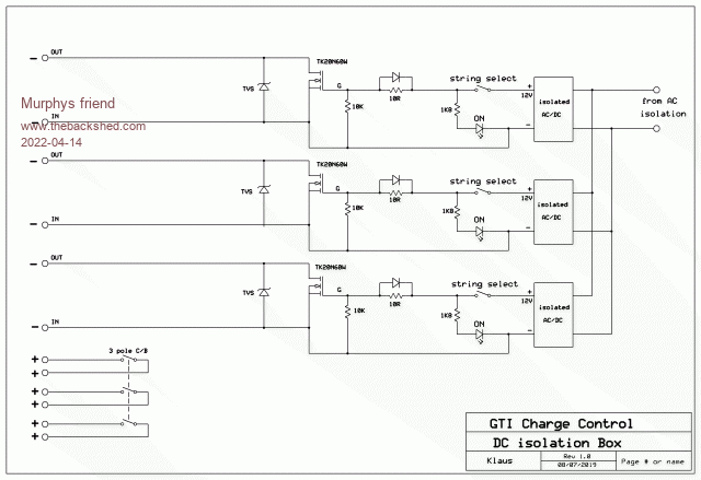

Posted: 08:35am 14 Apr 2022
Pete, that grid tie back charging works best in conjunction of a regular MPPT charger. That way the GTI cycling is much reduced in my experience, depending on how much MPPT charging you have. Some GTI's take a considerable time for their safety checks. The 3 sting one I use takes just 30 seconds.
Anyway I attach two schematics of how I do the on/off control of My GTI. Keep in mind this is now a 3.6KW 3 string device but before that I used a 1KW GTI successful. Just ignore the other string inputs on my first schematic.
The voltage sensing relay came from ebay, plenty to choose from there.

Pete, I should have mentioned that in my post above the first schematic is optional. I wanted to switch my 3 solar strings in and out individually (they face in 3 directions) and that method is a lot easier than trying to unplug solar connectors from the inverter.
The "excess" power feeding Noneya mentions is very true but you have to remember, if you are using my on/off battery charging regulator, the voltage sensing relay *will* turn your GTI off when the battery is full.
Loads will then be powered from the battery via your inverter (not grid tie). This goes on until the battery voltage drops low enough for the voltage sensing relay to turn the GTI charging back on.
Depending on your battery capacity this might happen annoyingly often during the day.
I get around this by having a separate 2KW of MPPT charging as well, that keeps loads happy and my battery full for most of the day. This way the GTI gets a rest after each mornings battery top up, unless a heavy power demand drops the battery voltage low enough.

I figured the first circuit had something with tying all the strings to the GTI.
I only plan on using the GTI on one panel string. They will be an 1800 watt string on a 2kw SMA inverter.
The regulator circuit for the GTI looks great. I have some on order.
