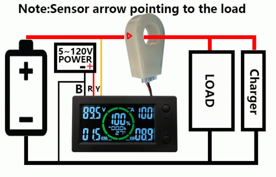

Junktek Battery monitor
Ive got one of these ( amoung others), I made the suggestion earlier to use a commercial one the transmits its info out... so you could easily transmit it via a arduino and a nrf24l01 or a esp32 etc... these one do both Bluetooth and serial ( rs485 ) as all the calibration, hardware etc. already sorted ( they pretty good ) ..
I think it works !!

Posted: 09:57pm 23 Oct 2023
Ive got one of them to test ( 2 actually, i like my backups).. problem with them was it only reads one direction for current flow... so it only reads flow, irrespective of wheather its flowing in or out...  so you might have 3kw going in with 500w usage, it will just show you 2.5kw discharging, if that makes sense...
