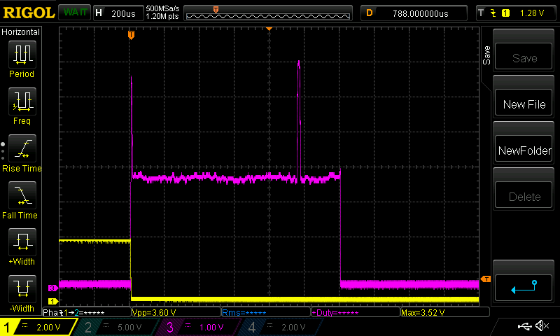

This is with the inverter off:

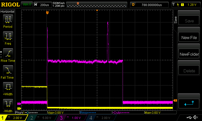

and with it on using the modified design

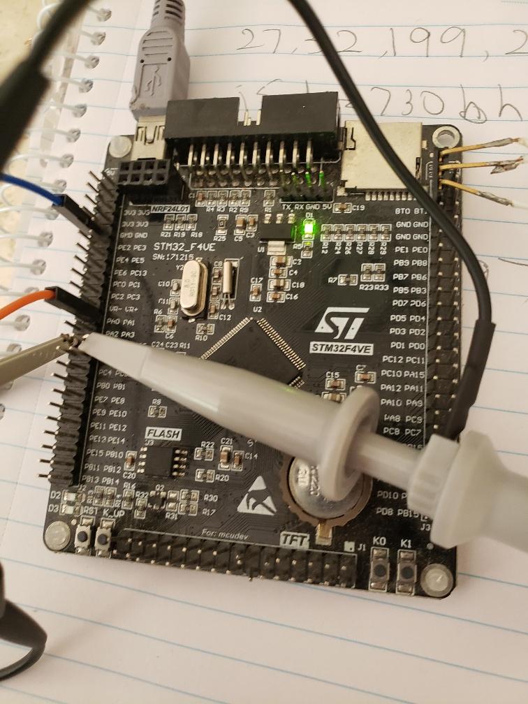

The board looks like this:
