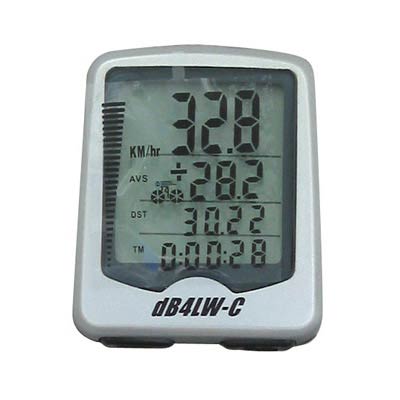

Hi
Just thought I would pass this on with the new cycling computer's that have Cadence built in. what it does it measures your pedal RPM's, so anyone want a easy digital RPM read out for there turbine here is is. About 20 bucks
enjoy
wayne

Hi wayne
Thank alot about cycling computer as l got one somewhere in my shed as l never throught about using it brilliant ideas

Bushman
just make sure it has Cadence built in and these are only on the newer ones, or you can use the older ones but have to work a little math with wheel dia and use speed read out. Tonight going to load on lathe and make sure it can read a fast RPM, so far only worked mine up to 200 RPM. You can get wireless ones too, but to much for my blood.
wayne
