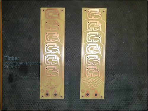

I have almost completed my ultracap set up now. First I made two PCB's
for the equalizing circuit. I used a simple high current shunt regulator that I saw in the Texas Instruments application notice for the TL431 adjustable precision shunt regulator.

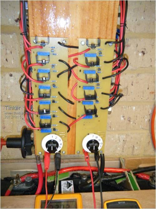

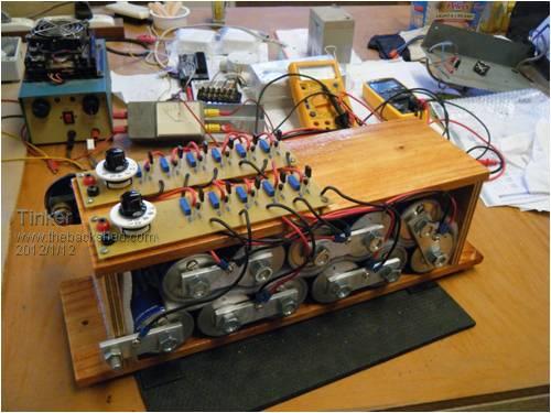

The complete arrangement, all wired up can be seen on this pic
There is a rotary switch on each board that selects an individual capacitor so that its terminal voltage can quickly be checked on a plugged in meter.
Each board accommodates 6 identical equalizers but since I only use 11 capacitors in my 24V nominal system one board has only 5.
First tests - with my variable power supply - indicates the circuits are working. One shunt transistor got very hot (its cap had the highest terminal voltage and excess was shunted off) so I think I will fit small heatsinks to each transistor.
Since my power supply only makes 26.5V max I was wondering why the transistor got hot as 26.5V is way below the max combined cap voltage limit. It turns out there appears to be a faulty TL431 on one board whose associated cap was way undercharged. I will fix that tomorrow, then do some more bench tests and if all is well mount the cap arrangement on the wall above the battery bank.

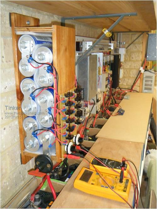

My ultracap bank is installed on the wall above the battery bank now.
The initial balancing worked rather batter than I expected. Each balancer was first preset to 2.60V. Then I connected the cap bank to my power bench supply set to 29V via a series resistor and watched the voltage at each cap slowly raise.
As soon as the first reached 2.6V its associated balancer started to shunt current to the others in the chain. The transistor got quite hot at this stage, just as well that I had fitted small heat sinks to each.
But the other caps quickly caught up and the transistors cooled down again.
Initially there was as much as 0.3V difference in charge on the capacitors. Once balanced that difference was about 10 milli Volt. 24 hours later they are still all within 30 milli Volt, even though today the battery bank never got full enough to reach the cut in of the balancers.
I think this circuit works rather well for my installation. Max battery bank voltage (set by the charge controller) is 29V. This equals 2.636V across each cap if they are balanced. Since the balancing starts at 2.6V there is a max of 36mV that the shunt transistors have to bleed off. These transistors are connected straight across the cap terminals, there is no series resistor.
First impressions are the battery bank overnight minimum voltage (caused by the fridge compressor starting up) is now higher. Time will tell what else is changed.

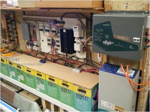

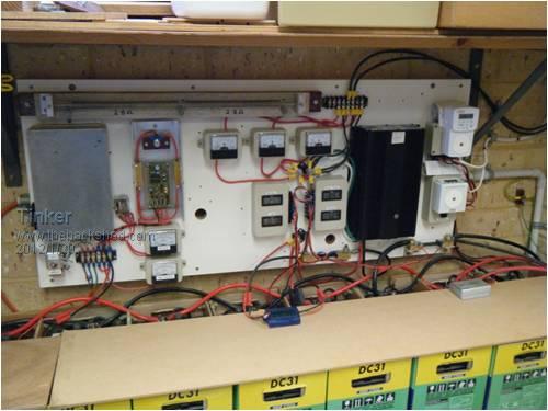

Thanks for your interest Robert, below are two more views of my RE power plant
Klaus

Tinker, Thanks for the additional photos of your setup. I really like the way you have everything so neat up on the wall. Very impressive system in my personal view. Excellent Mate!
Robert
