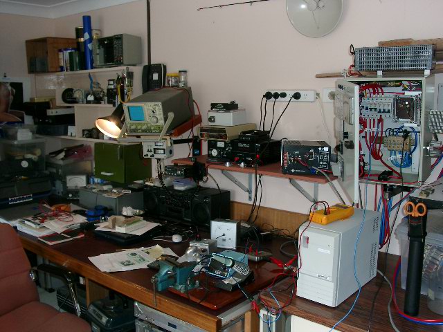

Bruce has the cleanest workskop in the southern hemisphere. True.
When you visit Bruce's place make sure you take some wood shavings and metal filings. When he isn't looking spread them around the floor, so it looks like a proper workshop.

Posted: 07:48pm 16 Nov 2005
Hahaha-- Not that way now ,Glenn, so many 'irons" in the fire at present ,I haven't had time to clean-up.
But I will be happy to have any visitors this Sunday.
A mighty site Glenn, congrats and thanks from all of us
Bruce

....well look at that! Amid all of that electronics equipment = is that a fishing rod I spy sneaking into the top of the picture?
Looks kinda new...has it had much use?
