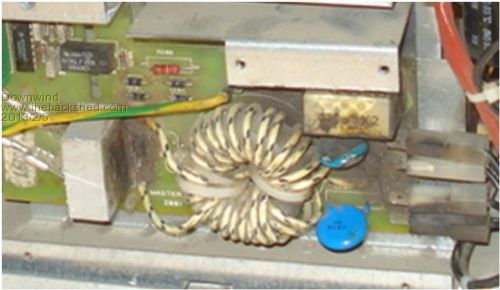

Hi,all members this forum.
In this weekends I bought in the ,,FLEAT MARKET,,one Keamppi 1500 master.EXCLUSIVE ACCESORIES
The seller said ,,IT is faulty but sure can be repaired,,
For repair i need some advice and schematic diagram.
The real pictures it is
Uploaded with ImageShack.us
Sure the first time i want disassemble piece by piece and clean all item
but not have schematic for assemble again and test control .
Best regardes and wait yours replay
IOAN
Posted: 03:11pm 04 Feb 2013
It looks like a Chinese puzzle to sort out.
There apears to be some fault on the lower circuit board, but that might be just how the photo looks.
I know nothing about Tig Welders so unable to help further.

sPuDd
Joined: 10/07/2007
Posts: 251
Posted: 05:19pm 04 Feb 2013
Looks like it got a boot full of over voltage running on a poorly loaded generator.
That burnt stuff all looks like MOVs & filters on the mains AC supply.
Unless its just filth.
sPuDd..

Posted: 03:33am 05 Feb 2013
Ok ,friends i try next day to clean then I will return with new pictures.
Thx for quick replay
However without scheme I will not deal with the position all PCB-S
BEST REGARDES
IOAN

Posted: 12:58am 14 Feb 2013
OK
now i disassemble my ,,Kemppi,,and make pictures .
I was helped by user ,,janne,, but now ask about PCB Z001 the filter power .
What values ​​have al resistors RZ 101 ,RZ102,RZ103.
I can start EXPERIMENTAL with different values FOR resistors RZ 101,RZ 102?
For RZ 103 the user ,,janne,, said in primay -VZ 105 (THE OPTOCUPLE)must have current
1--5mA.
See pictures with Z001
BEST REGRDES and wait yours informtion about my problem.
IOANEdited by IANOS 2013-02-15
