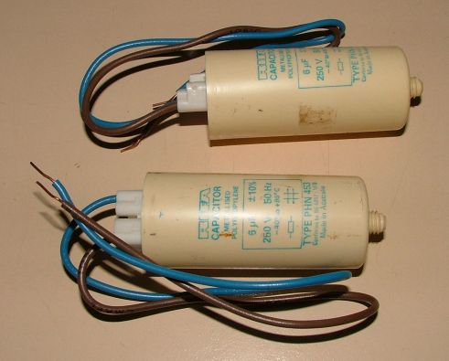

Ok, I dont know if this was the right thing to do, but I removed the capacitors from a couple of my fluro lights and its dropped the current draw 27%. To start the story, this afternoon I connected up the shed lights to my solar power plant ( 2 80W panels, couple of batteries, controller and 600watt modified square wave inverter ). Turned the lights on and they all worked fine, but I could hear that the inverter was working hard. Closer inspection showed it was drawing 41 amps from the batteries ( 12V set up ). That seamed a bit much I thought.
Now I remember when I was a kid of about 12 ( flash back thing happening here, stay with me ) the fluro in the bathroom blew up one night, big bang and lots of smoke. The electrician visited and took out a thing called a capacitor, a black chared mess. He said the fluro light didn't need it, and it was only there to make the fluro draw more power.
Now since then I've also heard the cap is there to phase correct, as the fluro is an inductive load a cap is needed to balance the phase loading and keep the power authority happy.
Anyway, back to the present. I tested one light circuit, consisting of 2 fluro lights fittings, 3 tubes ( 2 in one and 1 in the other ). When switched on it drew 15 amps from the battery bank. I climbed up on me ladder and took the capacitors out of both fluro fittings.
They are connected straight across the 240vac mains. Now when I turned the lights on the power draw had dropped to 11 amps, about 73% of the draw with the caps in place.
Now this raises a few questions. Is this power saving because I'm using a modified square wave inverter and the caps draw excess current on the abrupt square rise? Would the same gain be achieved if I used a sine wave inverter, or power from my normal grid supply? Is this capacitor needed at all, can they safely be left out for any fluro light, either on a cheap inverter or connected to the grid.
Needless to say, I'll be taking out the rest of the caps in the shed lights tomorrow.
GlennEdited by Gizmo 2007-05-02

I've had a good look around the internet and it looks like taking the cap out of circuit is a good idea, especially if you have a modified square wave inverter!
Its only there to provide some phase correction to keep the power authority happy, and not needed for the normal operation of the fluro light. On a square wave inverter it will have a big effect on the current draw, and life, of the inverter.

Yea you have the right answer. On a sine wave inverter the cap will reduce current but not power strange ha I will not try to explain. on the mod wave the steep front on the wave appears as high frequency and the cap acts as a short curcuit nearly

Posted: 10:42pm 09 Jun 2007
Ewww put the capacitor back in Glenn!
Fluro's themselves alter the power factor alot. The capacitor across the fluro's is designed to counter this.
The reason why it looks like your drawing less power is because your meter cant read how much reactive power you are taking, only the active power.
This is one of the ways to get free electricity from your power company, but if they catch you, they will install a power factor metre, and charge you an arm and a leg for the difference in power factor!
Posted: 10:56pm 09 Jun 2007
Hi Chris
I did some more testing a couple of weeks ago and there was only a power saving with the modified squarewave inverter, and no saving if I used sinewave power ( mains AC ).
I was measuring the DC current to the inverter, so it was giving a true power reading of the effect of removing the caps. Like herbnz mentions above, the leading sharp rise of the squarewave into the capacitor was drawing the extra current.
I also tested this with some fluros that were in the house ( not run from the cheap inverter ). If I removed the caps and used a AC ampmeter, there was little change in current used, infact some fluros actually drew more current with the caps removed.
So I've left the shed lights cap-less, these run of the modified squareware inverter, and the house lights keep their caps as these run of the mains AC.
Chris
