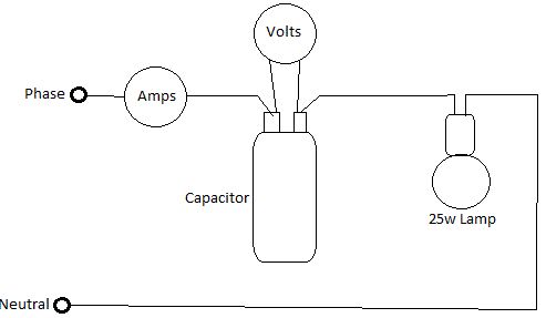

There is a fairly simple way to check mains rated caps. All you need is a 25watt lamp, a basic multimeter and a bit of a formula.
1/ Connect the circuit as shown with the capacitor in series with the lamp and a known AC voltage at the phase and neutral . Mains is good as it’s a known voltage and frequency.
2/ Turn it on. The lamp should glow. This will at least tell you there is something for the electrickery to get through.
3/ Measure the AC voltage across the capacitor and note it down.
4/ Measure the current through the circuit and note that down as well.
These are the only two numbers you need. Now to work out the value.
1/ Calculate the resistance as follows. Resistance = Voltage/Current. So if you have say 20volts measured across the capacitor and a circuit current of 0.1amp you will have a resistance of 200ohms.
2/ The capacitance can now be calculated using C=1/(2x PI x mains frequency x Resistance)
So 2x3.1415x50x200=62830
1/62830=0.0000159
This is the answer in Farrads. If you move the decimal point to the right by 6 places, you will have the answer in Microfarads. In this case near as damn it 16uF.

Fixed! First bought a new multimeter as I could not measure AC Amps with my $10 one. The new meter has capacitance included. The 12uF one measured OK.
The 50uF measured 3nF! The suggested schematic with lamp and the resulting calculations as suggested led to a weird 4000mF value and this is not an error in decimal places.
Anyway, the dead 50uF start cap was replaced with two paralleled 20+30uF starter caps from Jaycar and the motor spins again! The original 50uF cap fitted into a small plastic tube alongside the motor, the two and big new caps will have to be safely tucked away somewhere.

Posted: 08:44pm 21 May 2014
Great to see you have the hole making thing going again. Don't understand why the calculations didn't work though. The formulae does assume that you are dealing with sine waves as anything else can give incorrect readings on general meters. But you're back making spaces in bits of material which is the main thing :-)
domwild
Joined: 16/12/2005
Posts: 873
Posted: 08:53pm 21 May 2014
Pete,
I cannot understand that either and guess that a faulty cap may give erroneous readings. The formula of 1/2 * PI etc. reminds me of high school, where the physics teacher talked about pendulums and sine curves.
