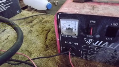

An actual meter reading on a 500 AH 24 volt bank I am re hydrating at 29 volts.

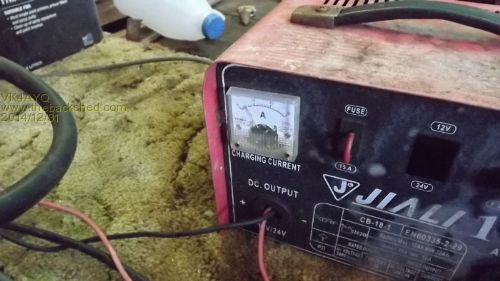

An actual meter reading on a floating at 27.5 volts, also re hydrating.
In the battery rescue thread I have also included the circuits of a 12 and 24 volt desulphator, they come highly recommended, I am getting the bits together to build a few 12 volt versions as I found that they work better than going across the 24 volts, on a new battery set i think the 24 volt one would be OK but in my case my battery bank needed a bit more to bring it back up as it had dehydrated over the last 15 years and the reclaiming has been a bit of a drag but is working.
