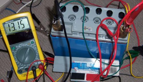

Posted: 04:42pm 21 Jan 2015
Little picture from pamphlet
And after breaking in and gradually topping up with water
George
