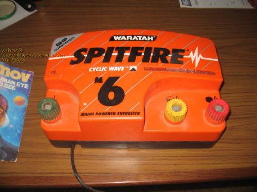

Had good intentions of sending it away to be fixed but it has sat on the shelf for quite a few years. it still powers up and triggers the pulse but no hurty sparks come out, so I figure there cant be a lot wrong with it.
it is a re-branded Stafix unit from NZ. from memory it can power more than 300 km of wire and the output should be 7500 volts at the red terminal.

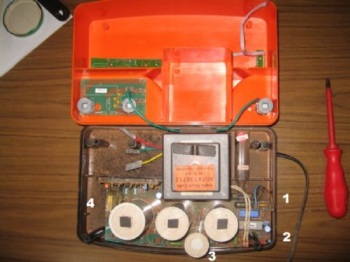

that would be my guess pete, one of the high voltage pulsed caps has failed or a diode that across the cap. I pulled the top off tonight, here is a photo inside.
section 1 is the mains input with the standard MOVaristor, fuse, a couple of diodes and a capacitor
section 2 low voltage pulses come from the transformer (white wires) and drive the lights on the front of the case
item 3 AC capacitor
item 4 wound coil/inductor
the three wires coming out of the transformer are green-ground, red-full power, yellow-half power. the wires that drive the transformer from the capacitors are underneath the board.
I will get a few closeup shots when I pull the board and transformer out to get at the terminals of the capacitors with my tester.
I can vouch that it has got plenty of grunt, if I hold onto a wire that is not electrified it will make my arms twitch just from the induction of the electrified wire close by.

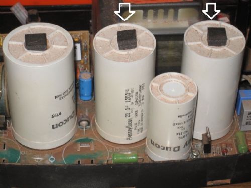

View of the 30 uF pulsed Cap, coil and the control board.
these are the boys that take the brunt of the load 1200VDC 20uF pulsed type P124
I think one of them will be cooked.

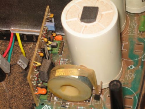

Looking at the first photo above I can see a SCR just in front of the coil and another in the second photo next to the smallest cap, it looks like BT136 written on one of them. Hopefully they are both triggering and resetting when they should and I dont have to fiddle with any of that.

As regards to its workings, and from what I can make out from the photos, it appears to be a standard configuration based on charging 1 or more high voltage caps up to around 400v+ and then dumping the charge through a low impedance step-up transformer at around 1hz to produce a pulse of several kV at quite a high current (many amps!)
The rest of the circuitry is tasked with pulse timing, voltage regulation, wave shaping, lightning protection and reducing RFI.
I would guess that the black trannie is the low impedance step-up and is potted to stop HV flashover. It looks like it has a tapped secondary for high and low power from the red & yellow terminals on the front. One of the triacs is probably used to switch the charge from the reservoir cap(s) to the trannie through the two white wires (primary).
The wound inductor (LHS) and the block caps on the RHS of the main board are for wave shaping to protect the triac and reduce RFI
There is possibly a capacitively coupled LV power supply to power the timing circuit on the small vertically mounted pc board.
The components most likely to have failed would be the tranny (o/c) the cap(s) or the triac, although from the photo it almost looks like the case has had water in it.

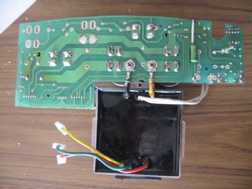

photo of the back
you can see the transformer primaries that I mentioned earlier, a couple tracks are cut with components added, if you look closely I have numbered the SCR's so you can see the track they are controlling, No2 is next to the coil.

SCR no.2 looks like the switch to dump the cap charge into the primary. Not sure about SCR 1 but possibly switched to control pulse shape/duration.
I guess the empty cap pads would be for the voltage doubling charge circuitry for the 110V version.
the empty cap pads are bypassed by a wire link for 230V that would be replaced by diodes for lower voltage versions. I dont know how many versions use the same board, it looks like quite a few.
