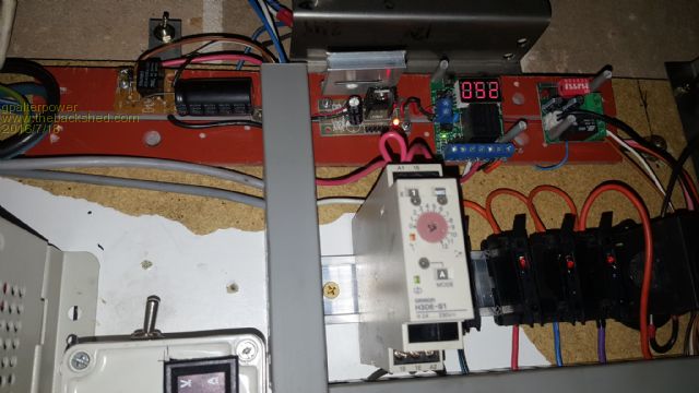

I have a similar setup on my system at home. I purchased one of those cheap power star inverters about a year ago. Its been reliable powering my home and small workshop every...single...day without a hickup. The only drawback is that it consumes 110w on standby. so I decided to attach as little power saving device so it shuts down when the battery voltage is low

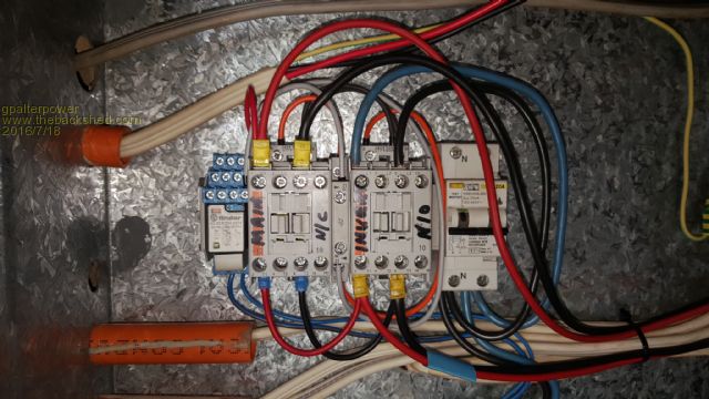

I live on grid/off grid. Off grid in the morning when the sun comes up and on grid after the sun goes down. I have a small battery bank but with more solar panels, some more batteries and if I can convince the the kids to turn off the lights and TV when not being used, I will be able to go off grid permanently. I have a dual contactor setup for the changeover, so only one contactor can be electrically energised and mechanically locked at a time. This ensures that there is NO chance of cross over to the main grid. That is a definate NO NO!!! Its energised by a small relay which in turn is activated by a volt detect relay
I purchased a programmable volt detect relay thru ebay. Bypassed the main switch on the inverter thru a small relay and in turn is activated by the volt detect relay thru a timer, which was added to the equation to give the inverter a 10 sec head start to turn on. That way there would be full power when the change over occurs. Another stay-on relay was fitted so the inverter stays on for 10 sec after shutdown.
Timer near centre and the volt relay is above and to the right. I programmed it to switch on a 27.6v and off at 24.4v . Been working perfectly for 6 months now.
