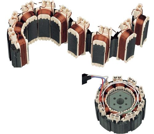

Are they a brushless DC motor or a induction motor controlled by a VFD.
What RPM is it normally rated to.
Can you easy access the windings to make changes.
Lets guess 1500 RPM normal motor speed at 240 volts.
That would give around 16 volts at 100 RPM and around 0.3 amp in a turbine, with doing some quick and dirty calculation, not really suitable without changes to windings if my guess is correct.

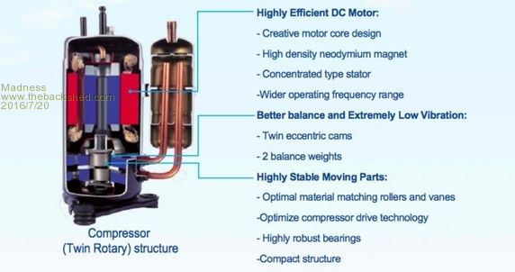

Air conditioners would get a lot bigger than 1000 watts also. There plenty that draw 3.6 KW and bigger 3 phase units.
You might be onto some thing, however 1000 - 6000 is very high RPM for most RE applications. Another thing to keep in mind is these compressors rely on the gas flowing through the motor to cool it.
Are you suggesting you want to run it off compressed air or similar?
