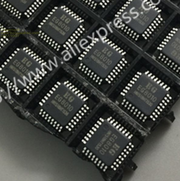

The EG8010 LQFP-32 sinewave inverter chip, that we know that works, ... should have the code ........... HN1518HT1536 on it.
Its those last 3 numbers that can be different.
I ploughed through Aliexpress until I could actually see those correct numbers on the chip. Like oztules I bought plenty, 80 or so, from different suppliers in the end I got 50 good ones.
This supplier was good. ..... but sadly no longer stocking?

Thanks oztules & clockman, your info is spot on. It appears I have the wrong type of EG8010 chips.
I must have forgotten about the different chips, I'm blaming senior moments...
Anyway, did some more tests with the chips I have today.
They are: HN1702HT1718
I eventually worked out a misunderstanding about how the 8010 works, should have read the application notes more thoroughly .

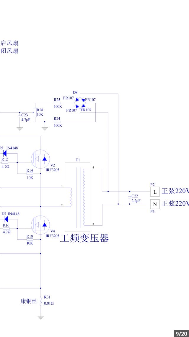

Actually as u can see they do rectify the feedback signal when using the " low power frequency transformer " which we are effectively using... also in a earlier post of oz's there was an issue about grounding, hence the small transformer for isolation. .
I think it works !!
