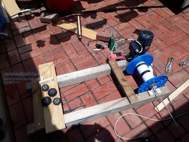

So far have 1 unwound and had some issues straitening the wire, so I came up with this from some old parts lying around.
Seems to work pretty well and is run by a frequency inverter so it can be slowed down to a manageable level.

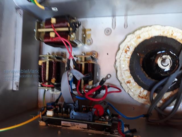

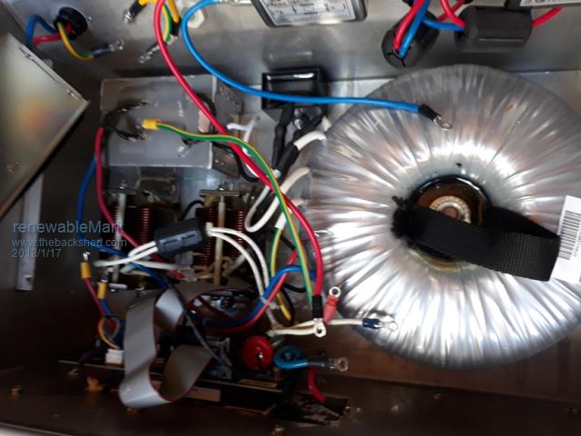

The second aero sharp I opened up looked different inside, one had one of the small transformers potted up with grey epoxy and the torroid had a cloth strap attached to it. The date was only a month apart from the other one that appears to be different.
So I'll unwind the second one and hopefully it's the same size.

I would avoid winding on that small spool as each time the wire bends it gets stiffer, that is one step you can avoid. I use push bike rim and roll it on to it as I pull the wire through the bearings. Then it comes off the bike rim very easily and you store it in neat coils.

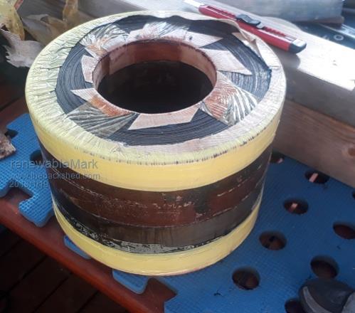

Finally got the second one unwound.
Thankfully both are exactly the same size.
