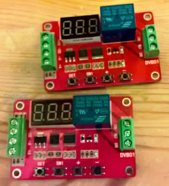

I have been testing several voltage comparators for the OzInverter projects.
This particular comparator gave me interest, it seems to do/promise what I want in its description. If it worked, it would be a simple cost effective addition board I could point folk towards.
https://www.aliexpress.com/item/quality-12V-DVB01-Digital-window-voltage-comparator-voltage-measurement-discharge-over-v oltage-overrun-protection/32718271902.html?spm=a2g0s.9042311.0.0.WkgMjD
But sadly the awful Chinese translation to English is just diabolical, although it had my tech savvy teenager boys here rolling around the floor with laughter.
Its a step through menu system with 4 push buttons, but sadly the normal logical steps for programming the unit is beyond my foolish comprehension.
Can any of you intelligent bright sparks here help?

Normally there are tutorials and explanations of these boards on YT.
Had a look for you but came up empty.
maybe they are relatively new and no one else has been able to figure the things out yet either. :0)
You are right about the terrible translations. I have come across these boards and even the descriptions are totally and pathetically wrong as to what the thing does.
Surely somewhere in china thee must be like an interpreting/ copyrighting service that these manufacturers can send the description in Chinese and get a reasonable English ( or other languages) back.

http://www.ssigjern.dk/manuals/41000275_uk.pdf
Is that one any better?

Good find Clockman, I was looking for such a gadget too. I ordered one and think I can make some sense of the manual if I have the unit in front of me and experiment with the buttons a bit.
Look at it as a challenge , you should be able to re write the gibberish into something sensible to put in your inverter book.

Thanks Guys.
Thanks Mark, that's a better translation than the one I have. I will give it another go for more fun and games.
I have set up a dispute with the seller saying that because of terrible programming instructions the product is useless, I await to see what alliexpress has to say.
I think the Chinese language is very different to English in its back tracking on the subject matter, hence the utter confusion.
Still have to smile with this below bit of translation from yours Mark !......
Kindy reminnder:
Controller will judge preset voltage V1 and V2, which one is the lower limit and upper limit voltage automatically according to the features. When user set the controller, no need to onsider the question which one is higher or lower and first or last.

Is this the same as the manual you already have?
2018-02-04_071708_41000275_uk.pdf
Here is a detailed video. Edited by Madness 2018-02-05

Thanks Mad, just looked at that video, it is excellent. For once an utube really showing the goods.

Thanks Madness,
The manual is as Mark listed.
Thanks Madness regards the video. It has better explanations for fools like me.
At the beginning I started to fall a sleep, hypnotic drone.
About 5 minutes in the stuff is explained and we are seeing the operation and setting the thing.
At 15 minutes the time delay is explained.
Its still far to geeky for normal folk, just trying to work out how to make the instructions more understandable. ?
