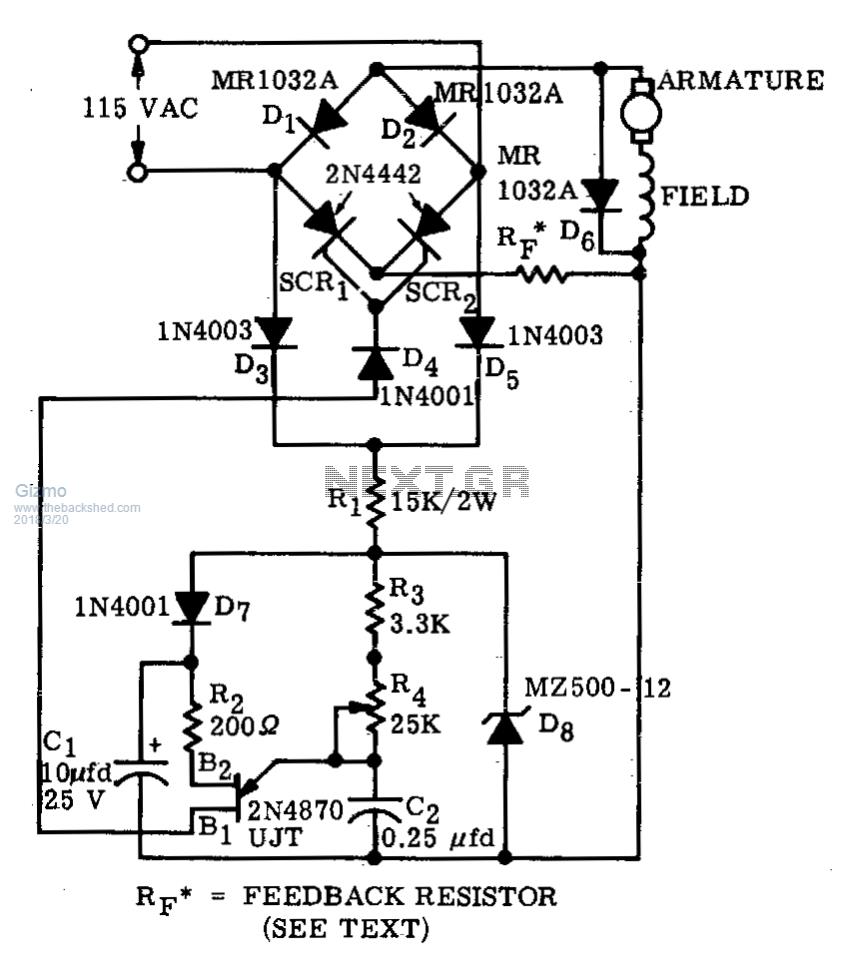

I did have to replace a SCR in the motor controller for my little lathe a couple of months ago, and I thought the circuit was clever. It use 2 diodes and 2 SCR's wired as a bridge rectifier. Control was smooth and linear.
I guess PWM would be the best option thought for a DC motor.

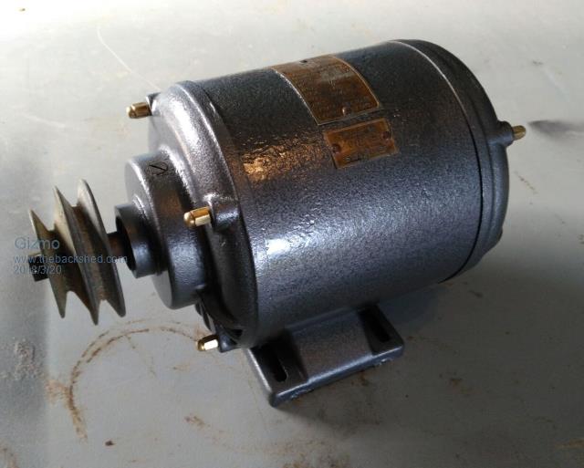

Tinker I'll take some photos of mine over the next week as I build it. It uses 2 14 inch wheels made from 24mm MDF on a steel frame. I do have a small Ryobi band saw, very handy, but it keeps breaking blades due to the small wheels. I'm building this think based on what I could find in my junk pile. The 1/2hp motor is a nice looking 1950's Ozy made unit, will post a picture. I pulled it apart a few weeks ago, replaced a few wires, oiled it up and painted, looks the job.

This is the old induction motor.
It's a Crompton Pankinson, Australia made ( back when we made stuff ), 1/2hp 1435rpm motor. This is probably the easiest, most reliable and better looking option for the band saw.
I have 3 DC motors. A 180v 1.25hp 4000rpm, a 130v 2.5hp 6700rpm, and a 220v 3hp 3400rpm.
I found this circuit, looks similar to the circuit used to control my lathe DC motor.

Check if that motor has a centrifugal start switch or is it capacitor start?
Had one of those motors on the cement mixer and the centrifugal start switch failed at times and would stall the generator, could be a pain.
