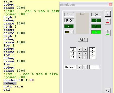

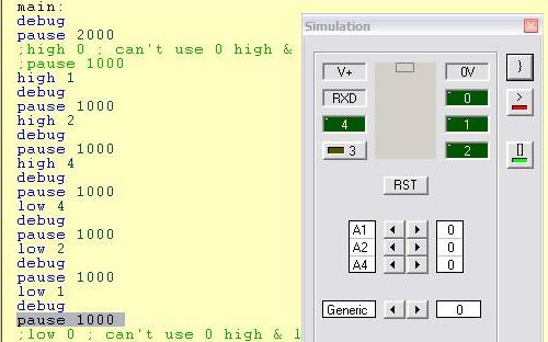

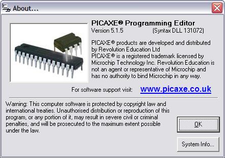

I have pasted the modified code that you posted, and I present the outputs. I have included the about screen for the programmer and 2 screen dumps from the running program. One just before the readadc command, and then just after.
I will test with a chip in the real world. There may be something with the version of the programmer.
There is no way that the pin 2 output should change state in this way.
I will continue tomorrow. .. Gordon.

I had installed the little update that takes V5.1.5 to V5.2.0. Perhaps it is a glitch in the software that has been fixed in the update? I bet you find the update before I send this so hopefully all good with simulation now.
