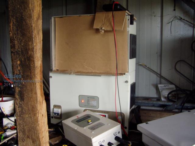

The inverter in question had the usual dual inspire box, where the electronics are in the bottom box, and the tranny in the top one.... but I had run out of lids for some reason I can't explain... so only the control box had a front to it.
The boxes are joined together, but there is a slot about 25mm wide most of the way between the boxes. This allows for the cables from the heat sinks to the transformer a tidy ingress and egress between the boxes.
Well. the hundreds of man sized moths, found this slot, because the leds on the control card would have emitted some light out through the slot.

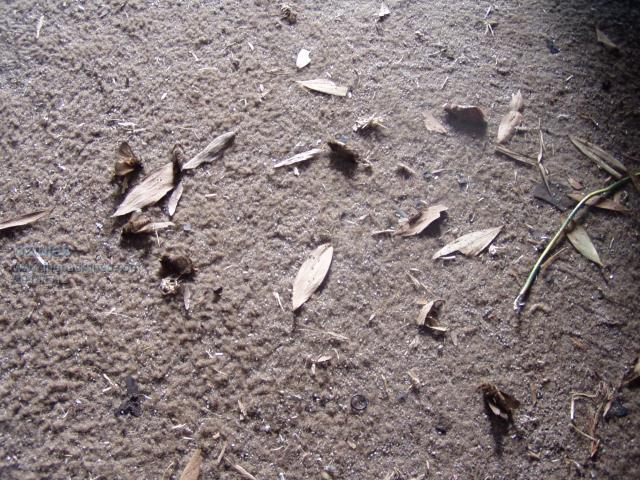

There was no wild life in the tranny box, but when I opened the bottom box front panel, there were hundreds of huge moths, and some little ones too, filling the box. It looked more like a bee hive full of huge bees.... and somewhere under all that pile of insects, was the control and power board.
Here are some of the lads that did not make their way out of the box under their own power

So having pressed the reset, I quickly fashioned a cardboard cover to keep the blighters out, and it is still running the house this morning as if nothing happened.

So thats it, still no real failures, except for my shoddy uncompleted facia panel.
So... beware... wild life needs to be excluded from these things. In all the others, they have proper fronts, with weather seals.... but not this one for the last few months. This is just another spare having a few months burn in.
