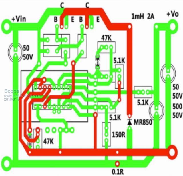

I looked at this thing (no other info forthcoming from the person who 'designed' it)
I cant even follow what its supposed to be doing (if anything)
Any ideas or is it as I suspect pure 'magic happens here'
eta the IC is a KA7500B a smps controller IC
eta2 info on the controller IC available here
https://www.mouser.com/ds/2/149/KA7500B-889308.pdfEdited by Boppa 2018-06-20

The question is why would you put any time into it. There are cheap motor controllers for only a couple bucks. This is actually a buck converter power supply using parallel PNP transistors. I wouldn't use that design. What voltage do you want in and out?

Because I suspect that this particular circuit as shown doesnt actually work at all....
I havent actually used this particular IC and my reading of the datasheet says that it isnt supposed to be wired this way, I was wondering if someone had come across anything like it before..

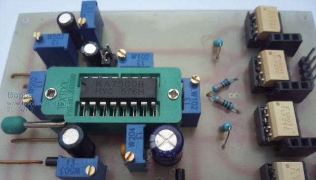

I dont seem to have the pic atm, but you can see he definitely made provision for it, every single resister apart from the two pullups and two base limit resisters is a multiturn trimpot!
I cant even imagine why????

Now I'm home, I mentioned before about they put adjustable resisters everywhere, here is the pic I got from them earlier that was on my home computer- a 'twiddle till it works' or just doesnt know what they are doing??
Even the ones that are fixed value in the datasheets I found, they put in adjustable multiturn trimpots- I suppose it is to make it look more 'technical' to non electronics people?
I notice now that their circuit is lifted pretty much from the datasheets for the pcb design, but it isnt the one they actually made up in the photo
