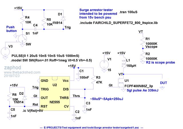

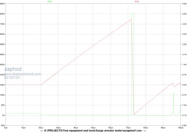

Something for the toolbox :) This is for testing high voltage VDR's and TVS devices you suspect might be kaput! The voltage available depends on the switching device used and the inductor construction, I just knocked this up from bit's in my junkbox/spares so the circuit and details are just as an idea that you can alter to suit :)
About the only critical factors are to ensure the energy is within the switching devices avalanche rating and the inductor doesnt saturate.
In my case my scope probes are only rated to 600V so a 10Meg resistor is also used to make a 2:1 attinuator with the probes imput impedance (also 10Meg) this resistor has to withstand half the peak voltage e.g. 400V so you may need more than one in series depending on what you have in your junkbox :)
Operation is simply tie the DUT across the switching device and likewise the scope (via the attinuator if reqd), set the latter to single shot and press the button, peak voltage should be the clamping voltage of the DUT, if its 800V (in this case) the DUT is failed open circuit!
Check the DUT isnt failed short circuit before placing in this circuit else you may overheat the inductor depending on your bench psu.
Hope this is a usefull idea to some :)
Note the mosfet model is encrypted on the ON website but of course you want the model for your mosfet :)
OOpps just spotted an error in the energy calculation, it's actually appx 1.9mJ

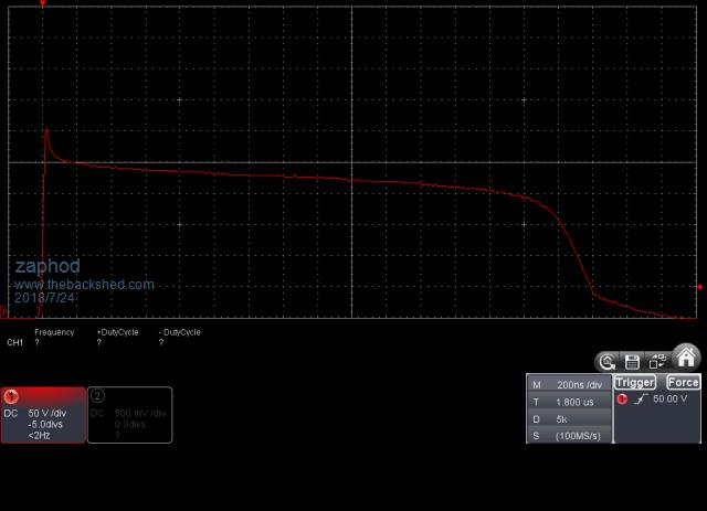

Anyway I built the circuit, works fine except the probe attinuator, I know I should have known better haha only works for DC not pulses and would take forever to calibrate so threw the towel in and ordered a 100:1 2Kv probe, hopefully enough to last me a while.
Enclosed pic shows 180Z VDR (nominal 180V) with normal scope probe at 50V/div of course the other aspect of this tester is the current starts high (~8A) then ramps to zero so the clamping voltage changes through the pulse although perhaps a pulse test will give you more of an idea how the device will perform with a real spike! Anyway the purpose is served of a basic go/nogo tester :)
Cheers Roger

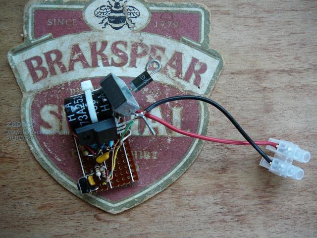

Just as good if you happen to have a small high voltage trafo in the junkbox :) Here is a picture of mine
Cheers Roger

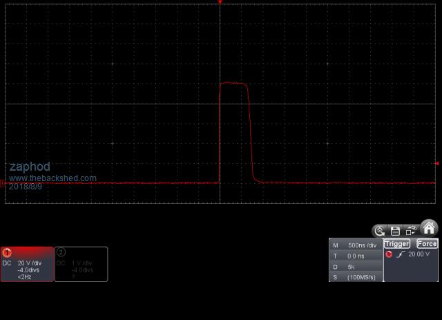

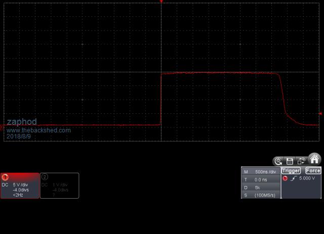

100:1 scope probe arrived good for 2Kv so here is the tester open circuit showing the mosfet avalanche at 1kV. This will be useful not only for testing protection devices but also for checking avalanche charecteristics of other devices at energies low enough to avoid destruction or ageing (hopefully).
For comparison here is a 1.5KE170A note the attinuator calibration is not good on these cheap USB scopes!
