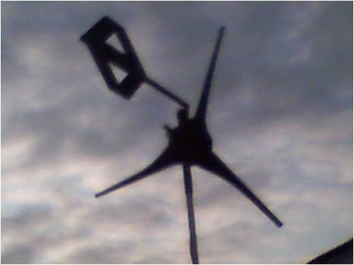

sorry my cell phone cam is pretty crappy
