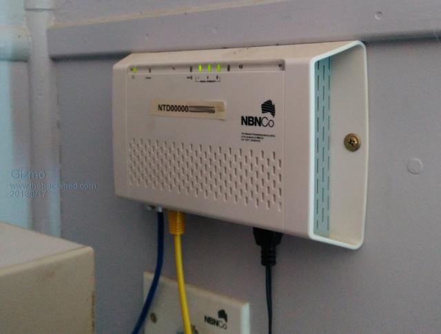

I tuned off the router. Still the hum. I unplugged the network cable to the NBN box. Silence! Must be the NBN Box power supply, its a wall wart type of supply, 12vdc at 2amps. Would be about 5 years old now, and runs all the time.

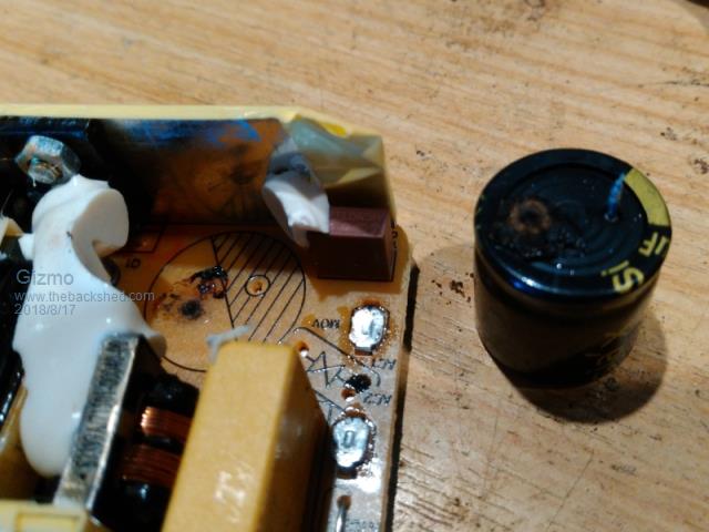

Google it, seams like everyone stocks NBN power supply replacements, even Jaycar, so they must fail often. I decided to pull mine apart and see if I could fix it. Cracked open the case and I could see the main filter cap had been warm, the glue around it has separated from its case. After desoldering one leg it basically fell out. The other leg had evaporated.
The cap was a Asia'X brand 47uF 400v, 18mm high and 18mm wide. The only one I could find in my collection that would fit was a 22uF 400v cap, that would do for now. I fitted the new cap, filled the gap with some hot glue, and put it back together.
