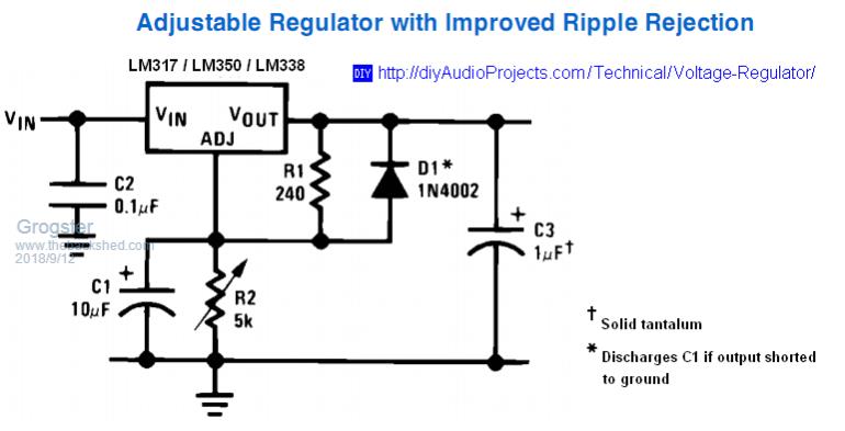

17v input, 14v output, 2.7A current.
Regulator is trying to dissipate: (17-14) x 2.7 = 8.1 Watts of heat - that's a lot for a TO220 package. I can't remember what the 338 is rated for, but I seem to recall all those linear regulators are 5W devices. I may well be wrong. I will now have to dig up the PDF so I can find out.
Why do you have a 10k/12k(can't read it) between ADJ and GND?
Why not just the pot? That is probably part of your problem. I don't normally have an additional resistor there...
Most adjustable regulator circuits have the 220/240 Ohm from output to adj, and a resistor from ADJ to ground to set the voltage. A variable regulator usually uses around 5k pot between ADJ and GND to vary the voltage.
You should also be using 100n caps in parallel with your electrolytic caps. The 100n's filter off any high-frequency noise that might upset the stability of the regulator. Not quite so critical on the output of the regulator, but I always put one on the input and output just to be safe.

Data Sheets Here
It may be getting too hot as G mentioned. Probably don't really need the big C on the output.
I assume you've checked the protection diodes (Orientation etc)
Should work unless a dud

I do know that the output cap is much smaller then the input cap, but I did not know about the 10uF per-amp thing. I tend to always stick 100uF on the output of most of my linear regulators. 1uF or so on LDO regulators. Again, depends on the datasheet for the device in question.
