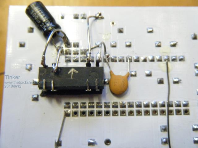

Oztules had a good point when he muttered "Pin 6 of the EG8010 and I have issues".
Madness was on the right track when he discovered using shielded wire for the ON/OFF switch at pin 6 reduces the funny business there.
Today I came to the conclusion that pin 6 is very particular as to its input. The very high currents inside this inverter, and powerful magnetic fields across the choke air gap can easily induce stray voltages in nearby wires. We want to be sure its not the wire to pin 6...
So I tried an even better solution than using shielded cable (there's always another way mad ) and it appears it does the trick.
So far I had modified only one inverter's control board but that 3KW inverter now can happily power my stick welder whereas before it would not. Before I could only tack weld from the inverter. Now I can lay on a full 3.2mm sticks worth of bead and keep on going.
I would be nice if somebody else could confirm my findings, always better to get additional results from inverters that have a different physical layout than mine has.
So, what did I do?
Simple, fit a small relay to do the switching right at the pin6.
I used a 5V DIL relay stuck to the back of my control board. Yes, I know, it looks crude but for testing purposes its fine.
So the front panel ON switch only turns the relay coil on. The N/O relay contacts connect right at pin 6 the shortest possible way. One side goes to +5V, the other to pin 6. This required cutting the original track to pin 6.
I also had fitted a 0.1uF ceramic between pin 6 & ground and changed that 10K resistor (which is permanently connected to pin 6) to a 5K1 size.
I further fitted another 10uF cap to the 5V line to ensure there is as little as possible noise there.
If you use this kind of relay be aware the coil contacts are only on one side. I choose this Rly for its size and high coil resistance since it is energised all the time the inverter runs.
Next job is to modify the 6KW inverter which is connected to the house so I can turn on microwave, induction oven and what else I get my hands on to see if the brownouts have gone for good.

Looks you have a dead cockroach there Klaus! Another alternative is to hardwire 5V to it and use the temperature feedback for shutdown. I won't be playing with mine for the next month or so as I will be away.
Why not use a MOSFET instead of the relay Klaus? WIth a 10K resistor to ground it will still turn off.Edited by Madness 2018-09-13
Gary, its experimental and a relay is what I had at hand.
Shall we leave the Mosfet idea to Wiseguy? .

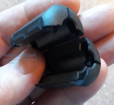

Hey what about an easier fix with a clip on ferrite?
It looks like the layout seems to have a lot to do with when it occurs, in a mild case like mine it may be just enough to solve it.

Note for users new to this relay, that some versions of these DIL/DIP relays that Klaus used have a diode internal to the device and are polarity conscious usually the Cathode is towards pin 2, Anode pin 6.
I was referring to the earlier version of those boards that did not use pin 6.
The ferrite will help with high frequency but if a current is induced at 5V it will probably have 0 effect.

Thanks mate, I'll give it a try anyway, still only happened three times, been over a week since it last did it. Klaus' layout seems to be more vulnerable to it for some reason, I never get it with big loads at all.
PS just after I took that pic a bloody spider ran out of it and up my arm. Going to nuke the shed now!!Edited by renewableMark 2018-09-14

I think you are on the right track there Klaus.
Have you tried an opto isolator instead of the relay?
It would be faster, and not suffer from the possible evils of contact bounce which might introduce some other "interesting" effects.

Been right over it, nothing loose, nothing hot, clamp tested each section to see if there were differences in current flow, everything looks fine. only ever does it around 3-5am. I have a funny feeling it has something to do with the heater in my sons room, just tested it when it clicks in and out at lower settings it makes the choke buzz like nothing else does, still not very loud but it's a noticeable difference to any other load. So presumably when that clicks in and out it could be sending nasty interference?? Anyway I put three filters on the switch line and we'll see if it does it again.
Also put a couple on the temp probe cable that is fitted to the torroid.
Hey Klaus, could you try the same thing with filters, you seem to be able to trigger the issue with high load, so will be much easier to test.Edited by renewableMark 2018-09-14
