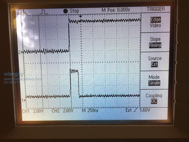

I have tried to discuss premature inverter failures on the forum a few times as I had a suspicion that all is not well. Despite the resistance to new ideas and the negativity and scorn I keep receiving I have continued to ignore it & evaluate the EG8010 as I have a desire to help others in a constructive manner (and it also benefits me).
If I am going to use the EG8010 I want to know about any bad behaviour that it has so I may avoid some of the pain and frustration that others have faced.
The first clue that all is not well in EG8010 land is that the updated EGS002 board has external transistors on the SPWM outputs to eliminate cross conduction. I eluded to this point in an earlier post that it may have been prudent to include those transistors on the Mad controller boards - I was confident they served a purpose.

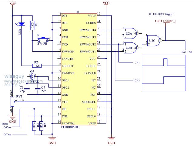

So today I soldered my EG8010 on an adaptor board and set it up on my prototype board with the minimum components required to bring it to life and operate.
To test my theory I grabbed a quad nand gate & put 2 nand gate inputs on the SPWM1&2 outputs and another two on the SPWM3&4 outputs. If ever either of the nand gate outputs become low we can potentially kiss our FETs goodbye. For the non technical (should you be reading this...) a nand gate will provide a high output as long as both inputs are never high at the same time.
By coupling the two nand gates into yet another nand gate we can monitor both halves of the bridge. Now if either side of the bridge has 2 concurrent (high) drives to the upper and lower FETs the third nand output will go high and trigger the CRO so we can see the evidence. Remember there is supposed to be a 300nSec dead-time between the on transitions from the upper to lower FET and vice versa, so if the CRO triggers it would appear that something is seriously amiss ?
Bingo! Within a few minutes after switch on I had captured a 250nSec pulse overlap generated after a disturbance. Over temperature or over current will cause the glitch, just as the fault (O/temp or O/Curr) condition is removed and the LED becomes steady again the glitch appears. Over and under voltage behaves slightly differently & will also cause the glitch on the chips third attempt to re-start.
I will post my schematic and a CRO shot of the event and implore that someone (maybe Poida?) may run some tests to duplicate my results. I have just the one EG8010 that I tested but I am confident that my findings will be verified. If Poida uses that nice looking Rigol it will probably have a A&B = high trigger to avoid wiring in the nand gates?
So in summary if this is the smoking gun, it explains a few things. Most inverter failures happen after a start/restart. If prior to the restart there was no over temperature or feedback voltage out of range event that stopped the inverter then all is well. I havent fully analysed an overcurrent thyristor shut down, I believe it needs a power down to restart, which might then avoid the glitch occurence. Setting up the inverter properly ala a Tinker pre-run setup, gives the inverter the best chance of starting properly with everything in range and avoiding a pyrotechnic display.
I am nowhere near finished torturing this device - maybe this is its one and only achilles heel, but I doubt it ?
I am busy for the next few days but I will wire in the anti cross conduction transistors and prove (or not) that the glitch is gone.

Solar Mike - I will definitely be placing some logic at the SPWM outputs for a few reasons not all that I wish to publish at this time - I am over the arguing and criticisms.
Noneya - Maybe I wrote too many words. The guts is that when set up properly and then turned on, an inverter may run indefinitely whether running small or huge transformers and small or huge loads.
However if you ever have an overtemp or under/over voltage shutdown event (I havent modelled the overcurrent behaviour yet) I wish you good luck - but it will probably go bang.
Likewise if you have not set up the unit in a similar fashion to Klaus's excellent set up guide, it may go bang very prematurely.
Let me state once and for all - I like the EG8010 I believe that it can make my inverter work reliably and well. I couldnt write software like Mad, Poida or Solar Mike to save my life. But I can find & design out hardware issues and foibles & I dont give in easily - thats my forte.

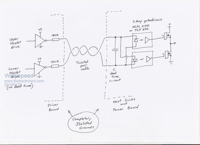

I have tried to discuss premature inverter failures on the forum a few times as I had a suspicion that all is not well. Despite the resistance to new ideas and the negativity and scorn I keep receiving I have continued to ignore it.[/quote]
Yes indeed. I have just about given up trying to help people here, it only results in being attacked and rubbished, its just no longer worth the aggravation.
There are a great many unknowns in these Chinese chips and their internal software and functioning. They could be very susceptible to noise and random crashes/restarts.
No way of knowing really.
But a very clean noise free power source and ground for the control board, and complete optical isolation between the control board and the very noisy high power bridge may help a lot.
That is also the place to add some very simple bullet proof extra cross conduction protection.
There needs to be multiple layers of protection.
Make sure nothing bad can ever happen by being extra careful, then add an extra layer of protection on top of that for when the impossible does one day happen.
Here is a very simple circuit I came up with a few years ago to positively protect from cross conduction, fully optically isolate the control system from the power board, and optionally add some dead time by adding a single capacitor.
Its impossible for both opto isolators to be on together, no matter what.
And it totally isolated the control board ground from the very noisy sources of the lower mosfets.
A balanced twisted pair will also have much higher noise immunity than the horrible ribbon cable, especially if it goes near the lower heatsink pair that are switching very fast at high voltage.

I can assemble PCBs use the testing as described as a precaution but since I started using Totem pole drivers I have not had any unexplained failures. As said previously I have had an inverter running 8 months without any failure and I only shut it down to work on my electrical wiring. In fact I am overseas at the moment and we have someone house sitting and my solar system is still working fine without me there and I have no reason to think it will fail.
If you feel by adding the additional information about having to use a series resistance when testing without capacitors or asking what is the problem is with over temp shutdown and restart is trying to discredit you then I think it is best I just stay right out of it.

Thank you for the cordial reply Mad. I did not mention the series resistor in my simplified version of Oztules testing (it wan not meant as a guide to follow) the pertinent part was the limiting of available energy to destruct - even with a series resistor the capacitors would be well able to kill things for a shoot through event.
There is an issue I have identified that after an over-temperature event a shoot through condition is clearly evident. Maybe in some configurations it has not/is not causing a problem. Maybe in some versions of the EG8010 this doesn't happen. I dont have all the answers yet but I consider this an important enough point to raise and communicate to the forum because it IS happening on the current release of the EG8010 and its ability to destruct is high.
