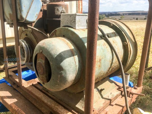

I've come across this big old 6kva 4 pole Dunlite generator with a Lombardini diesel engine. I'm not sure if the engine runs yet but thats not really important, my main concern is getting the alternator running.

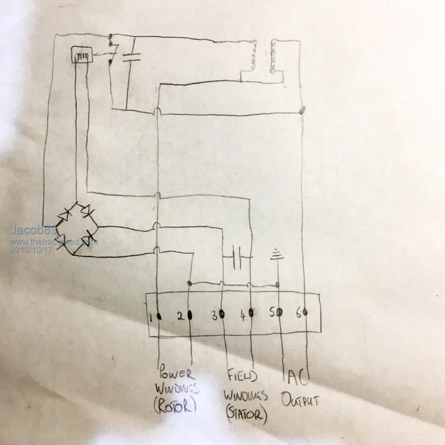

It has what seems to be an old style of AVR. At first I couldn't for the life of me figure out how it was supposed to work, until I realised that the field findings are stationary and the power windings are in the rotor. I've never seen an alternator set up like this but maybe it used to be more common.

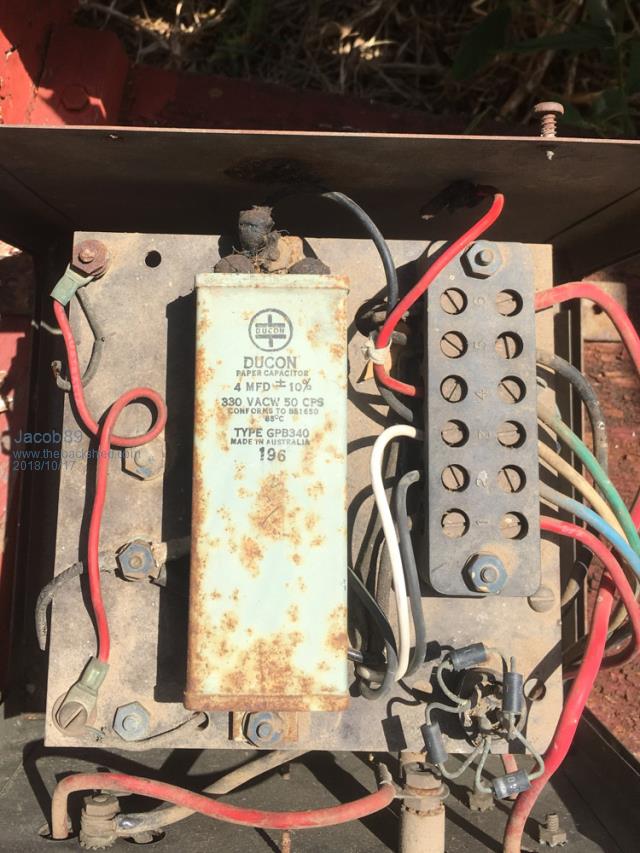

Basically there seems to be a transformer, the primary winding of which is in series with the load. So the greater the load, the more current through the primary and I guess the more current is produced in the secondary, which feeds the field. There is some capacitors and a contactor in the circuit, the purpose of which I haven't really gotten my head around.
I'm not sure its worth attempting to resurrect the original AVR, its not in great shape. I was originally going to throw a cheap universal AVR at it, but they seem to be made for more common rotating field generators with a field winding resistance of 10-100ohms and operate at about 90v. My field winding has a resistance of 140ohms. I'm guessing its designed to operate at a higher voltage (and therefore lower current).

I have an Onan 10KW Diesel generator that I resurrected and the AVR was missing. It is the type with a brushless rotating field, I fitted one of these AVR boards. The only modification I made was to add a 5 ohm series resistor as the Onan had 7 or 8 ohms resistance, it works perfectly. It would be worth trying the same AVR with yours the higher resistance should not bother it but the high voltage might be an issue. However that AVR does work up to 90VDC, you may be able to use the new AVR to control a transistor with the existing transformer.

Yeah pretty impressed with the output stability of the new AVR. I don't exactly how old this thing is but there is a capacitor in the there that is made in Australia and was discontinued in the sixties, and I actually found it on a list of components known to contain PCBs. No point messing around with it.

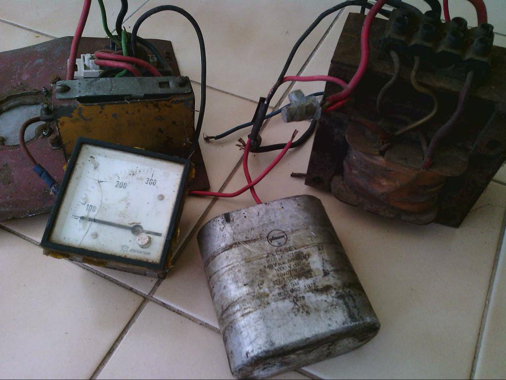

Very similar to yours, 20uF oil filled capacitor, current transformer, and big screw terminal block.
