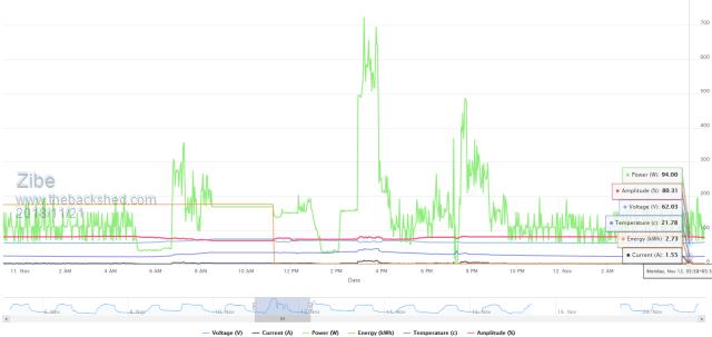

Posted: 10:24pm 20 Nov 2018
Looks like this.
