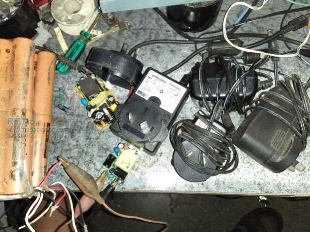

I have scavenged about half a dozen AC-DC converters that are of useful voltage output apart from 1 at 3v.
some of the 5v usb phone chargers work on the 50v battery bank as well as a 9v unit that will be running a fan on the other inverter, and a 12 volt unit that might run the fans for the Mad inverter although it is only 1Amp.
Also an old 24v Logitech AC-DC converter that used to run the force feedback joystick also runs well.
I have a 15V AC-DC converter however it refuses to run off the 50v battery bank, seems some of these things require a much higher voltage to run, would be a bugger to buy one and find that out later.

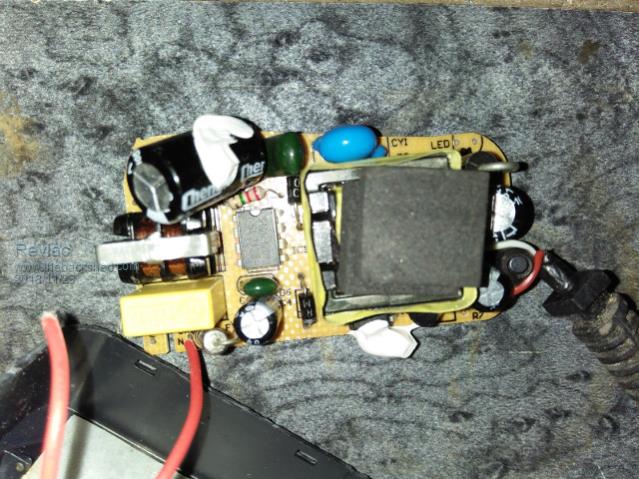

See that 2.2M resistor. It is the boot up to get it started. On those converters that have trouble starting on 50V, change this to 270K. It still must be operated at reduced power. More than enough for most micro applications. The internal FET of the chip can easily be 35-40 ohms when on so there will be extra heating. Add some heat sinking. Those with external FET fare much better. Often there are filter inductors or resistors on the input. I short these out for lower voltage drop. Also, I'll remove all but one diode to eliminate that drop. Every volt counts.

Thanks Hotwater That works good now.
This IC is SL2128 so the resistor connects to pin2, must be many different IC's around that are used for these.

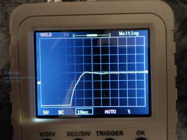

Thought it be worthwhile checking for any power spikes when powering up, after many startups, never saw any.
