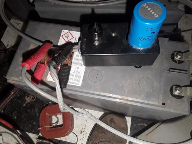

This is one of my five capacitor battery charger
I just love it I put it in a little box as you can see it has a smaller capacitor on the inside the Box has a switch on it to switch from the bigger capacitor to the smaller one the smaller one is a half amp the larger one is a little over an amp I use it to restore batteries and it works very well for me I thought about building one that puts out a lot more amps but have it so far have any of you or anybody you know built a large one that maybe puts out 10 amps or 20 amp. Feel free to comment in any way you can add to this or other subjects
I would like to caution again it is very dangerous if anybody has a good plan on how to make it safe like to hear about itEdited by BenandAmber 2019-02-27

Hmm, I've seen these before. I built one using motor run capacitors from old A/C units. There is a nice book from Eagle Research on building the capacitive battery charger.
One needs to be aware though that there is without a battery connected, DC mains voltage at the battery clips.

Yes they are very dangerous and I kind of wish I didn't start this post
Everyone reading this need to take note that a lot of people have died doing this exact same thing
And a lot of the people that died was not no dummies they were highly intelligent and well-qualified in electricity
So anyone that might decide to make one of these they do work and they do work very well
Be warned they will kill you and you cannot have one of these around children pets Neighbors you got to treat it like a firearm
One little slip up like all us human beings do on a daily basis could be the end of your life with this battery charger
This battery charger works best when you have a battery that shows 12 volts but when you go to crank a car over it just clicks
So in other words when a battery shows close to full Voltage but has no capacity this battery charger will make your battery have a lot more capacity
And I would also only use this battery charger as a last resort but not use it on a good battery just to try to get the capacity up
There are a lot of circuits out there for battery Chargers that do the same thing as this but not as dangerous
Which one of them works I have no clue this is the only one I've came across the works but it's also the only one that I've ever tried
Extreme Caution every human being makes a mistake every once in awhile and with this charger it could be your last!!!!!Edited by BenandAmber 2019-07-17
