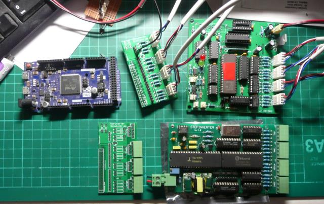

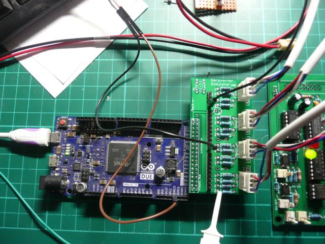

The Warpverter Simulator pcb plugs into the rear connector of the Arduino Due.

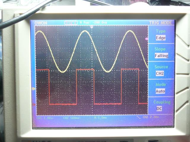

The output of DAC0 can be displayed on your Scope.
Press the button and it will grab two frames (50Hz) and output the data from the SerialUSB. (60 Hz is no problem)
The data is in 10 micro-Second intervals.
Details of the project can be found at Warpverter Simulator Github
The PCB takes 4 pin molex connectors (suits me) and 3.81mm Pluggable terminal blocks to suit Tony's boards. Tony's Inverter board is in the bottom half of the photo - mine in the top half.
This is an example of the output data sent by the DUE.
2019-04-15_172702_Warpverter_Simulator_Serial_output.zip
I need 2 pcbs and I'm sending Tony 2. The other 6 are up for grabs.

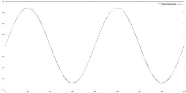

I'm running up the stm32_Warpverter at the moment and feeding it into the simulator. I could notice a little asymmetry at the bottom of the cycle. Feeding the frame data into GNUplot showed it up very well.
Then I loaded the data from both the eprom based inverter and the stm32_Warpverter onto the one chart.
I spent many hours with a logic analyser when I wrote the software to generate the Eprom I use. This is much better
I tried to use OpenOffice Calc charting but I just could not get it right. I don't want to install MS office.
I will use calc to look for DC bias and calculate Distortion, it'd be nice to use the chart as well.
I'll run Tony's Inverter board into the simulator and we'll get another comparison.
To see the images better you'll need to download the zip file.
2019-04-17_121525_Eprom_vs_Stm.zip

You're right. These little discrepancies are probably negligible compared to both, the area under the curve (its what counts), and what we do after it leaves the processor and into the world of real life electronics and transformers.
Be that as it may, I changed my algorithm so it should be faster and more correct. The evidence.
2019-04-17_142018_stm32_WarpverterV2.zip
I'm happy with that.
Andrew
Warpspeed
Joined: 09/08/2007
Posts: 4406
Posted: 04:36am 17 Apr 2019
Sheer perfection Andrew, well done !
This is a perfect demonstration of the usefulness of Andrew's simulator for anyone wishing to write their own from scratch Warpverter driver software.
If care is taken with getting the transformer turns ratios as close as possible, it is just amazing how four simple square wave inverters can create such a perfect sine wave.
Cheers,  Tony.
