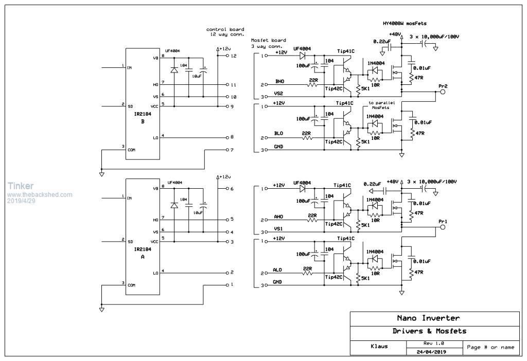

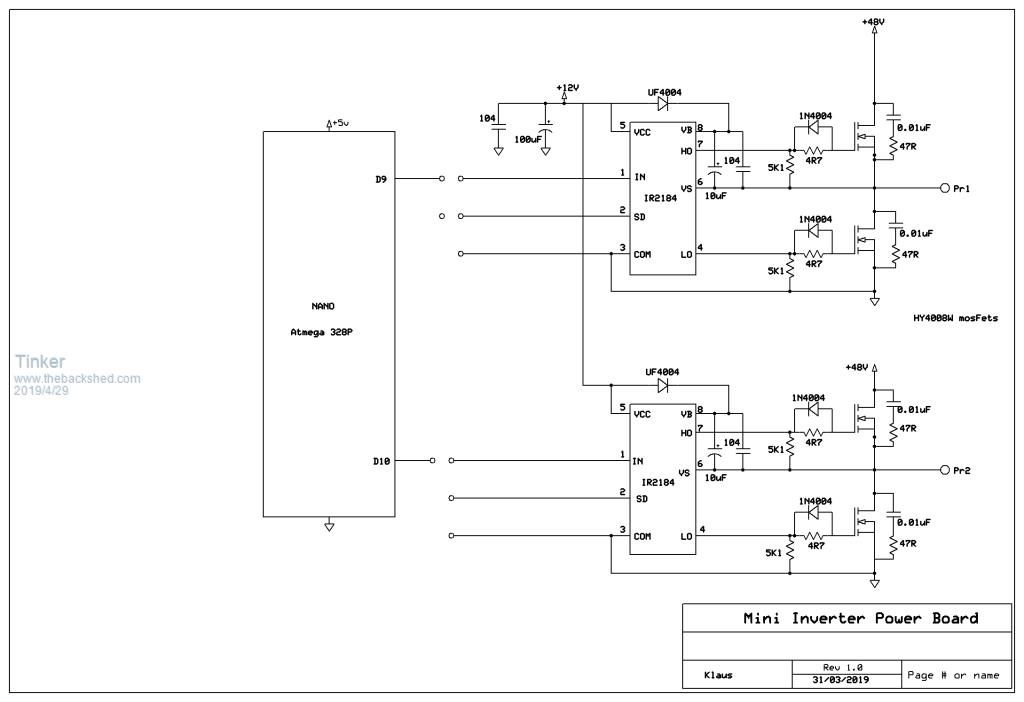

This is the nano inverter without totem pole drivers:

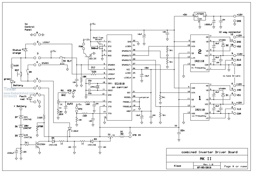

And here is the original EG8010/IR2110 control board.
To be replaced by the nano board, the totem pole drivers are at the right side and these are the same the EG8010/IR2110 board connected to:
Note the connections are done via a 12way header cable that has 4 x 3way headers at the far end. I use the same cable, making sure the connections on the new nano control board correspond.
I copied the charge pump +12V supply as it was at the IR2110 drivers, did I go wrong there?

Looks like the A\B H0 totem pole V+ 12 volts supply if derived via the charge pump should go to the VB output of the IR drivers (Pin8), you have it wired to Vcc +12v.

Thanks for that Mike, you confirmed my suspicion. Unfortunately have to wait now until the next batch of HY4008's arrives to confirm. This gives me time to modify that PCB, its a blessing they are so cheap in the 100x100 size.
The strange thing is, if you look at the original EG8010/IR2110 schematic, the totem pole used there (not shown on drawing) has its own +12V and not from the VB at the IR2110's. It works fine there.
I guess the IR2184's are different.

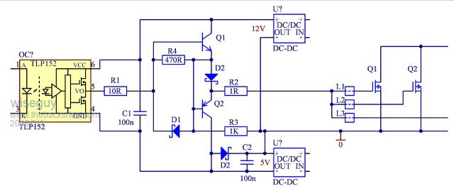

Here is the gate drive that drives the gate to ~ 11.5V and when off it holds the gate at ~ -4.5 (note a 12V supply in lieu of the 5V could be substituted for more serious neg bias). I will breadboard it soon to prove the concept and switching speed etc.
I decided to do a discrete buffer instead of using the MIC4452 so I could incorporate a gate clamp in the absence of power. Only the Low side FETs for both lower legs of the Bridge stage will have the negative bias/clamp circuit and they would both share the same bias supplies.
I know its a bit ugly but all the bits actually do stuff. It is essentially an emitter follower current driver and an active gate clamp. I believe it will survive a turn on event without charging the caps first (cant say how the contactor would like it though)
Edited by wiseguy 2019-05-02
