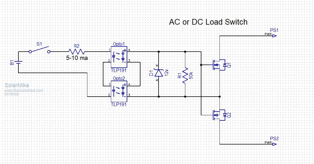

Good project, I have quickly drawn a proposed circuit for a load switch using back to back mosfets, so others here can better visualize what you are talking about.
Individual mosfets have to be rated for the voltage you will be using, suggest 200v min rating if using 150 vdc. HY4008 will blow up here.
They are not being switched off and on as per an inverter, so the driver circuit can be extremely simplified. Here I have used 2 voltage generating opto-couplers, each outputs approx 8 volts at very low current, so two in series will output approx 16 volts, the zener limits this to 12, or you could go to 15; would make no difference.
The gates in the mosfets will charge up over a few tens of microseconds; they do switch off faster as the drivers have active turn off. So the load as seen by the mosfets is a pulse period in microseconds where the load transition occurs. Power dissipated is minimal as determined by the (RDson * current) per device, you will not require very big heat sinks. Essentially they are operating at DC, all mosfets have a DC load rating dominated by RDSon * current and size of internal die connections. If you limit the current load to approx 80% device rating, shouldn't have too many problems.

Warpspeed
Joined: 09/08/2007
Posts: 4406
Posted: 11:11pm 07 May 2019
This is definitely the best way to build a high power isolated switch, for either ac or dc.
There are a whole family of photovoltaic isolators around, the TPL191 is just one member that produces a fully isolated floating dc voltage.
The switching speed will be relatively slow, and its highly unlikely any dangerous transient voltages will be produced.
It might still be a good precaution to fit a transient voltage suppressor between PS1 and PS2 for higher voltage operation.
Cheers,  Tony.

first of all THANK YOU for the schematic.
where would one place the MOV(s) and what should their rating(s) be?
I wanted to understand this a bit more - why would not the 80V Vds rated HY4008 put in "series" be able to withstand 150V switched across them?
Place MOVs across Drain, Source pins, no MOV is going to stop damage caused by a direct strike, its low power static and induced voltages that I would be more worried about, get some with a breakdown voltage that will protect the mosfet.
80 + 80 individual rating wont give you 150 with back to back mosfets, one or other of the internal diodes is always conducting.
What if I already have a 180V 1.5kW TVS diode across DS already?
Place a MOV in parallel to that as well?
Ah! You're right, and since the internal diode is but an integral part of the mosfet structure, a higher than spec'd DS would/could cause breakdown of the mosfet structure, damaging it.
I should have thought about it. I did not think deeply enough.

That little circuit of Solar Mike's had me intrigued so I went looking for suitable Mosfets.
Not a lot on offer in the 200V low RDS on range so, how would that one suit:
IRFP 4427PBF, 25mOhm, 65A TO247, $2.41ea. I prefer the TO247 package BTW.
Those TLP191 Opto's cost twice as much each.

  Tinker said   That little circuit of Solar Mike's had me intrigued so I went looking for suitable Mosfets.
My source, LCSC parts
I use the IRFP4668 in the mppt controller 200v, 130a 9mR, these would be ideal as a load switch.
LadyN: you are not interpreting the SOA curve correctly, when the device is turned on it has virtually no DC voltage drop across it, so is operating in the DC part of the curve where max current is determined by the silicon and its internal wiring. As for 100 degrees C, they will not be getting anywhere near that.
Mike
