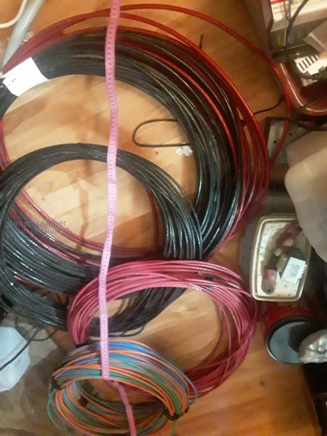

I got a pretty good deal on a 130 lb new 8 6 and 2 gauge wire today
