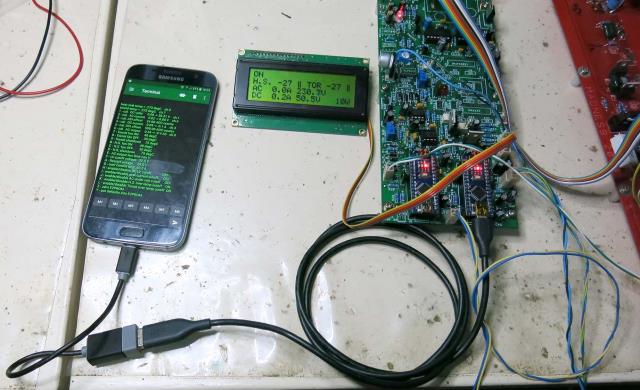

And since there can be ground loop issues, that upset calibration,
if you have an Android based phone, you can do this:
Use the phone as a terminal. This is isolated and so it is ideal
for accurate calibration.
Just get a $4 USB OTG cable to suit the phone. My Samsung Galaxy S7 needed
a micro USB type. The terminal app is free.
It works really well.

When using the Android mobile phone and cable to connect, one thing to keep in mind is to ensure the terminal app is using the same baud rate as the nano expects.
Ensure the comms settings are 115200, 8 bits, no parity and 1 stop bit.
I use the app "Serial USB Terminal", by Kai Morich
