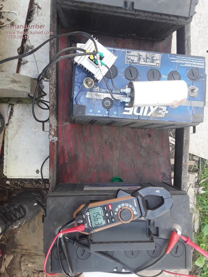

Posted: 06:45pm 09 Aug 2019
Put new starting batteries in the bus the other day decided to try to recover a couple of the three that came out of it
Third day At A little over amp and a half maybe another day or two to go
Edited 2019-08-10 04:46 by BenandAmber

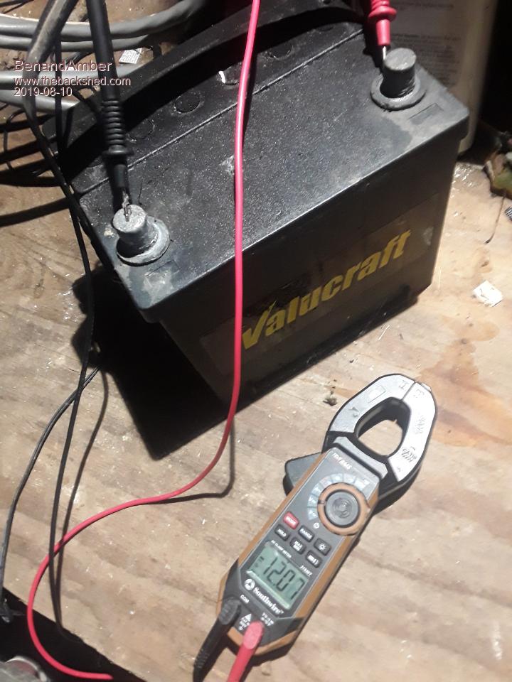

Posted: 01:27am 10 Aug 2019
I would have to agree with you solar Mike
But if the battery is not damaged other than sulfated
this method seems to work really well matter of fact the first one that I ever did just died the other day
I used it on my Onan generator for two or three years and then my buddy. Staregazer used it in his Mustang 4 about a year-and-a-half
When the battery was giving to me it would take a charge and read almost full Voltage but when you tried to crank your engine over it would just click
I dumped all of the acid out of it and made a solution Epsom salt you know the kind that smells like old lady
that's the only kind I can find at the time
I don't think that the Epsom salt is such a good idea
Now I just leave the battery acid in there and top it off if necessary
When Jacob got married he went on vacation afterwards and was gone for a month
the Mustang has always ran down a battery after a few days of not running it
so the reason it died was the Mustang killed it
I haven't lost hope I just haven't had a chance to put it on the capacitance battery charger yet
it may still have a few good years in it lol
just checked it and it's still reading 12 volts
this batteries resting voltage has always been over 13 volts since I put the Epsom salt in there
it seems to have a little bit less capacity then a normal battery of this size maybe 75%
I think that's something to do with the Epsom salt I've had similar results every time I've used it
With all this said I still agree with you
It's not worth doing unless your battery is just sulfated any other problem it's not going to fix
Edited 2019-08-10 11:37 by BenandAmber
